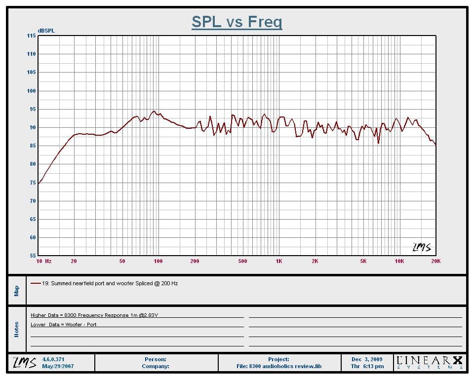

Figure 1: RBH 8300 SE/R Summed Nearfield Response
Trying to remove the room from the equation as much as possible, we conducted a summed nearfield response of the 8300 SE/Rs.  The woofers and port were measured nearfield and summed at 200Hz with the 1 meter tweeter response to produce this curve.  As you can see, the 8300 SE/R’s exhibit excellent frequency response linearity with a -3dB point in the low 20Hz range.

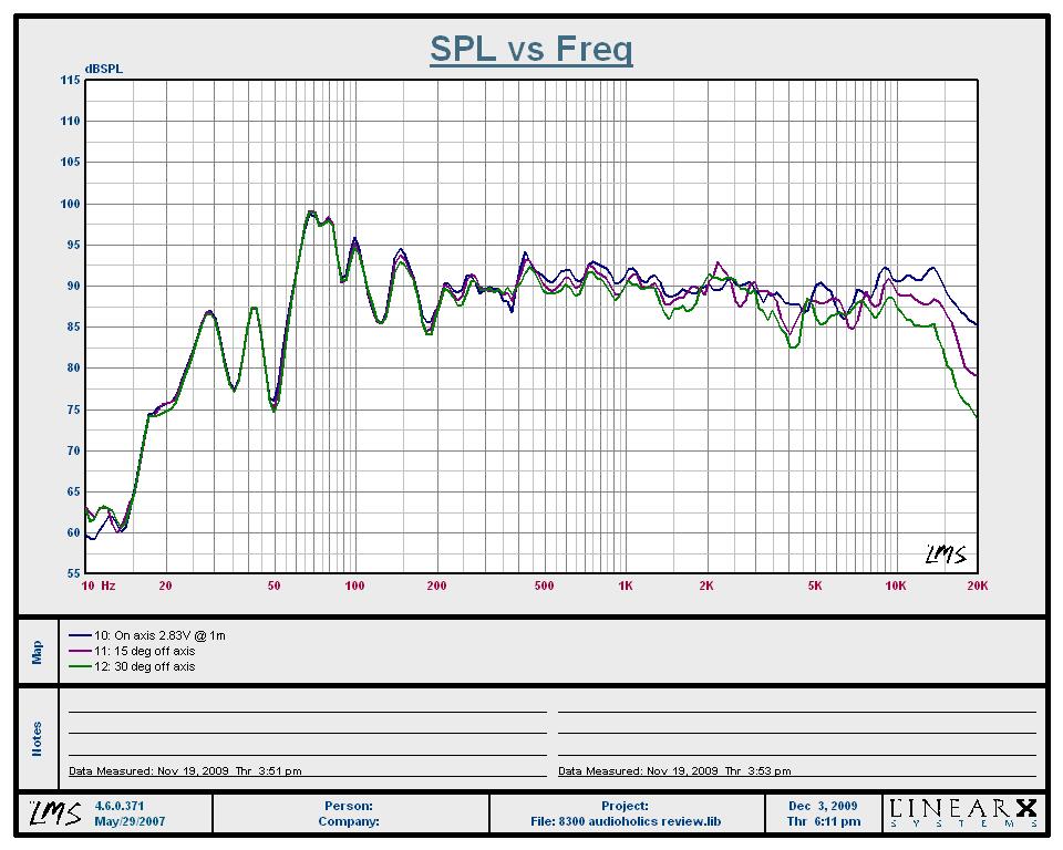

Figure 2: RBH 8300 SE/R 1 meter in-room response
Blue: on-axis; purple: 15 deg off-axis; green: 30 deg off-axis
The on/off axis response of the 8300 SE/R’s is very uniform indicating no weird cabinet diffraction issues or crossover anomalies.  As you can see the midrange response of the 8300 SE/Rs is extremely linear both on/ off axis and the overall response seems smoothest 15 degrees off axis.

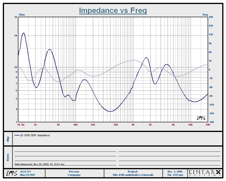

Figure 3:  RBH 8300 SE/R Impedance/Phase response
As expected, the 8300 SE/Rs have an impedance minimum right around 20Hz which is close to their tuning frequency.  These speakers dip down to 4 ohms at around 500Hz which is fine for most amplifiers, especially given the high efficiency of their design.  Phase response is kept within a +30/-45 degree window which is very good.  These speakers are best powered with quality amplification to truly shine and we recommend not skimping on power with these babies as they can certainly handle it.
