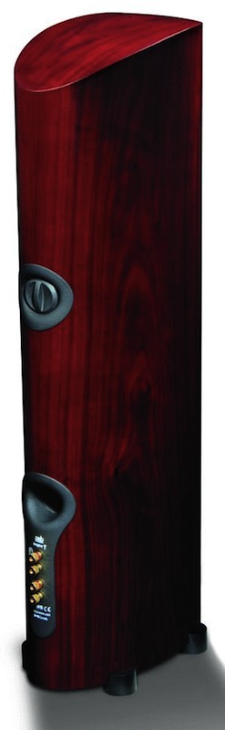

The PSB Imagine T towers are fairly diminutive as towers go. They weigh in at a slight 40.6 pounds and are just over 37" high, 13.5" deep, and 8.25" wide. The light weight means you won't have trouble moving them around. They are equipped with outriggers with either rubber nubs (for tile/wood floors) or spikes (for carpet) so their narrow width doesn't make them unstable. As many speakers are these days the Imagine T's have a rounded cabinet that is narrower in the back than the front. This is to combat standing waves in the cabinet. PSB achieves this design by using up to seven layers of laminated 3mm-thick MDF. The front baffle is reinforced to 1.5" thick. The real wood veneer is available in Black Ash or Dark Cherry (shown).
Taking a look at the back, you'll notice two ports. The top one comes from the factory with a molded rubber plug installed. You can switch the port plug between the two ports or order additional plugs from PSB.  There are dual sets of five-way binding posts on the back (installed vertically) for bi-amping the tweeter/midrange and the woofer separately (or if you have extra wire lying around, you can bi-wire them). On the front, you'll fine a classical TMM driver arrangement (though it really is a TMW as the top woofer is functioning as a midrange in this speaker). The tweeter is a 1" titanium dome with ferrofluid. We don't know what it is with the Canadians but they sure love their titanium dome tweeters. The woofers are 5.25" and have cones that are constructed out of a clay/ceramic filled polypropylene. They also sport bullet-shaped aluminum phase plugs. The drivers are all flush mounted to the front baffle with no visible fasteners. There is full-face speaker grill which connects via the normal post method. With the driver's fasteners all hidden, it seems a shame that PSB didn't decide to use magnets. This would have made for a completely clean face with the grill off.

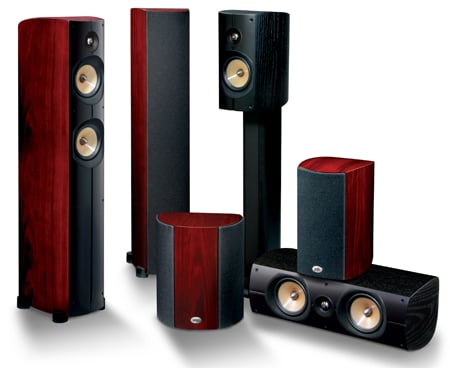

psb_imagine.jpgThe PSB Speakers Imagine T tower floorstanding speakers look to be quite a lot of speaker for the $2000 a pair asking price. We recently conducted a single-blind $1500-$2000 Floorstanding Speaker Shootout and really wish we could have had the Imagine T speakers represented (they didn't exist at the time). From an aesthetic standpoint, they are quite something to behold. We like all the thought that went into the design (especially the included outriggers) though we would have preferred to see a magnetic grill. The measurements look to be very robust and highly impressive considering the price. Of course, the Imagine line from PSB isn't just the T's (stands for Tower). It includes the B (bookshelves) for $1000 a pair, the S (surrounds) for $1200/pair, and the C (center) for $800 each. A full 5.0 system is going to put you back $4000 for the T's or $3000 with the B's. While not an entry level system by any means, it is well within reach of most dedicated Audioholics.
