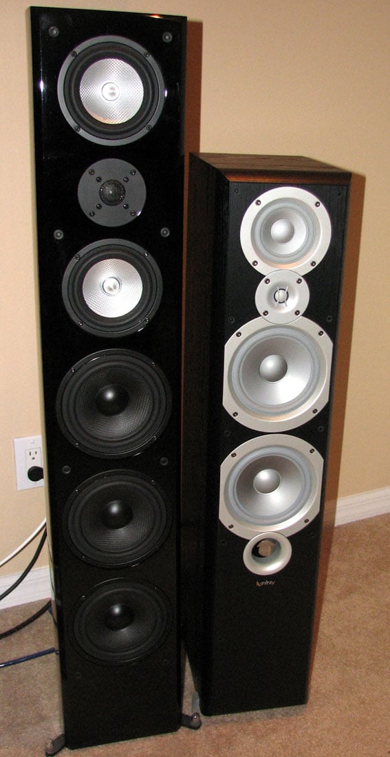

Listening Scenario #2: Friend’s House to CompareP363_E55.jpg
Again, using the Audioholics demo CD, I conducted some brief listening comparisons with my friend between the Infinity P363 and EMP E55Ti (rev1) towers. The EMP’s ($795/pr) carry a slightly higher retail price than the Infinity P363’s but both brands are regarded as producing high value oriented products so I thought it would be good measure to directly face them off in a controlled blind listening test. I found the Infinity’s were only 1dB more efficient than the EMP speakers despite they were spec’d to be 5dB more efficient! Levels were matched each time the switching occurred between the two speakers.
Listening to Fourplay “Chant” revealed that the Infinity P363’s dug a bit deeper than the EMP’s and had more sparkle on the top end. Although the Infinity’s won points on bass extension, the bass response wasn’t quite as tight or snappy as the EMPs. This became more apparent as volume level increased. Both speakers did a great job of achieving high output levels without causing woofer bottoming which this track will often do to speakers not well damped to prevent this undesirable nasty from occurring.
As we listened to more jazz-oriented music such as Pat Metheny/Scofield “Say a Brother’s Name”, we both clearly preferred the sonic attributes of the EMP speakers. The Infinity’s were able to convey more detail in the top end, but the reverb in the guitars just popped better on the EMPs. Listening to Sade “Hang on to your Love” showcased the strengths and weaknesses of both speakers. The EMP’s sounded a bit flat in the bass but the vocals were very natural and open sounding. The Infinity’s put forth more flavor to the sound but also made Sade’s vocals sound more electronic. We moved on to Santana’s “Put your Lights On” and started cranking the juice. High listening levels is where the biggest audible differences between the speakers presented themselves. Both speakers were able to play loudly without complaint, but the EMP’s seemed to be better behaved. The Infinity’s just sounded more busy in direct comparison but this was not surprising given how much more cone area the larger EMP speakers had. Quite frankly at low to modest listening levels the sonic differences between the two speakers were subtle and highly dependent on program material. Music favoring female vocals and brass instruments really highlighted the positive attributes of the EMP speakers while music favoring bass intense or high frequency effects showcased the product positives of the Infinity’s. Both speakers sounded great in their own respects as we were amazed by the level of performance achievable of such modestly priced products. The casual listener favoring more electronic or rock music would likely prefer the Infinity’s while the more discerning listener who appreciates Jazz and vocal intense music would likely gravitate towards the EMPs. If price were the key determining issue for making a purchasing decision and you’re able to get the Infinity P363’s for less than half the price of the EMP E55Ti’s, then I’d say go for the Infinity’s. If you don’t mind spending a little more for a speaker that can play more effortlessly at high SPL and also offers better build quality and cosmetics, then go for the EMPs. Both speakers will play fine as full-range towers though the EMP’s would benefit even more by supplementing their rather anemic low end bass output with a powered subwoofer.
