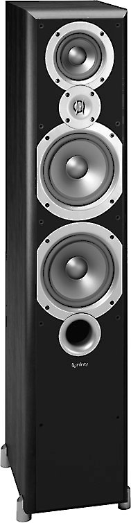

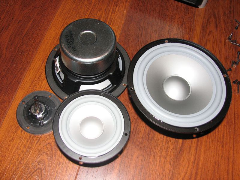

The Infinity Primus P363 is a rather compact 3-way tower design, standing about 3 ½ feet tall and sporting 4 drivers. They are designed and engineered by Harman in California but manufactured in China to keep costs down. The P363’s employ Infinity’s patented MMD “Metal Matrix Diaphragm” which is just a fancy name for a coated aluminum cone. I examined the cones and found them to be extremely stiff (good thing) while also being well damped to ensure a gradual break up mode. The dual 6.5” drivers produce the bass in this speaker up to around 350Hz where the mid frequencies are handed off to a 4” MMD midrange driver. These drivers employ stamped baskets with no venting and also use bucking magnets adding unnecessary weight and cost. If this were just for those still using a CRT display, it would be a waste, but more and more manufacturers are claiming that these magnets redirect flux back into the pole piece. The drivers employ 1” voice coils and a rather stiff suspension and spider to prevent excessive cone movement. There is not a lot of motor force here, but a speaker at this price isn’t expected to produce gobs of bass at meaningful output levels. The tweeter is an MMD ¾” hard dome with a rather anemic-looking neodymium motor structure. Luckily it is crossed over fairly high (around 3.3kHz) so it’s not tasked with producing the lower treble frequencies at high power, which it’s simply incapable of doing. Infinity also incorporated a wave guide or shallow horn to increase tweeter sensitivity and control directivity in an effort to better integrate the frequency response between the midrange and tweeter. I am a fan of the MMD cone material Infinity uses on these drivers, but would have liked to see the shielded magnets dropped in favor of allocating that budget towards beefing up the motor structures and voice coils a bit.

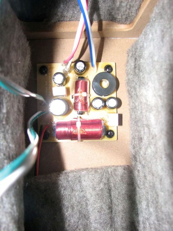

There is nothing particularly special about the parts Infinity chose in these crossovers. They are the same crossover boards from the P360 predecessor employing a 2nd order network on the bass drivers (consisting of an iron core choke and electrolytic caps), 2nd order high pass filter on the midrange and a 4th order response between the midrange and the tweeter at 3.3kHz utilizing an air core inductor. While the parts usage was arguably ho-hum, it was nice to see that Infinity paid attention to proper bandwidth limiting on the drivers. We’ve seen more expensive speakers run with nothing but a padding resistor on their tweeter and no crossover at all on the midrange driver which introduces a host of performance problems. This was NOT the case with the P363’s. Personally I’d like to see Infinity replace the electrolytic with mylar caps as they not only offer a performance advantage, but also a longevity one as well. The crossover board was mounted on the back of the cabinet and connected to a single pair of 5-way binding posts on the rear bottom end of the cabinet.

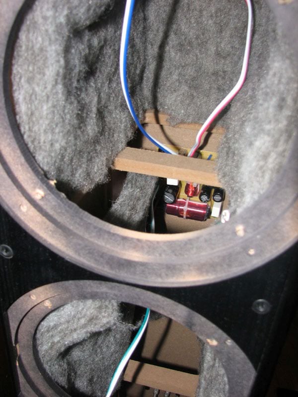

Infinity P363 Internal View thru front baffle: driver mounts (left pic), bottom cabinet (right pic)

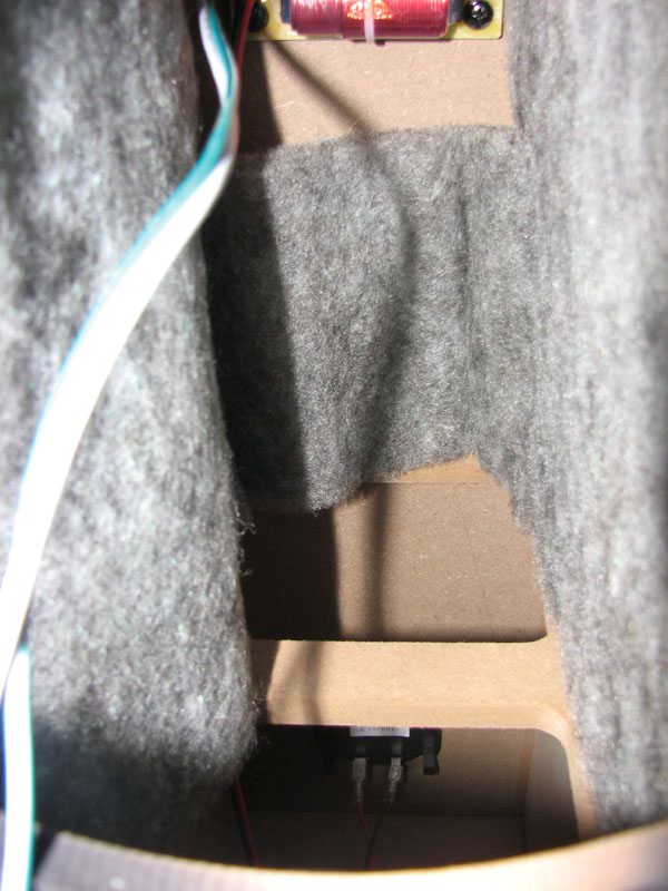

The cabinet is constructed of 5/8” MDF but the front baffle is thinner due to the cutouts for the silver plastic driver covers that are presumably meant to increase the speaker’s visual appeal. Harman marketing didn’t get the memo on how front baffle rigidity is the most important part to make thick on a cabinet. I’d prefer to see Infinity ditch these silver driver covers and just stick to an entirely black and thicker front baffle with the drivers all flush mounted. I measured areas that were less than ½” thick right where the drivers mount. Luckily, Infinity was smart and employed thick stick bracing framed around the circumference of the cabinet in those areas to add rigidity. The cabinet was conservatively lined with rather thin gray insulation along the walls but was completely hollow at the bottom of the cabinet where sound foam is needed most to help dampen standing waves. The cabinet is vented with a 1” deep, 2“ circumference port on the front baffle below the bottom driver. The midrange driver was encased in its own plastic cup and was heavily insulated.

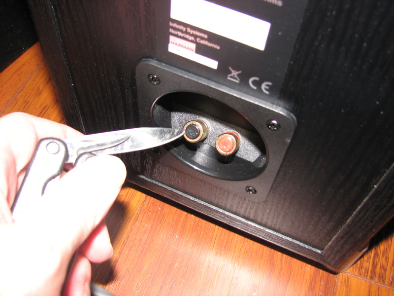

The P363’s came with rather generic style connectors. It also had annoying plastic plugs glued into the back of the binding posts making it impossible for me to use banana plug cables. After spending nearly 15 minutes trying to pry them out, I had to use my drill to drill them out of the binding posts. This was very frustrating to me as it was the first time I’ve ever seen plastic protecting caps glued into a binding post so snugly. Harman told me they do this to be compliant with a European CE regulation. The ¾” spacing between the posts means the Euro AC plug with its two round prongs can be plugged directly into a speaker’s binding posts. The plastic plugs prevent this. Why anyone in Europe would ever think of plugging their AC cord into a speaker is a question no one has ever been able to answer. But, I’d venture to guess there’s a less tumultuous way Infinity could have accomplishing this since I’ve never encountered this problem before on other review speakers.

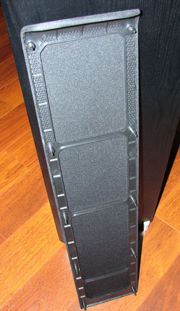

The grilles of the Infinity P363 towers are constructed of flimsy plastic but the cloth is wound tight around the frame to minimize losses. They cover almost the entire front baffle (including the port) and wrap around the top edge of the cabinet. The grilles aren’t the magnetic type that’s becoming more popular these days with speakers, and the plastic pegs make for a very snug fit onto the front baffle. In fact, you really have to give quite a tug to remove them.
