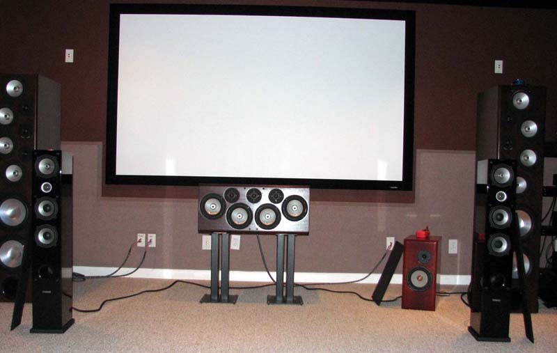

setupI set up the BD 1000s in the Audioholics Showcase home theater room using my Marantz PM-11S2 Integrated amplifier and Denon DVD-A1UDCI BD player as the source.  The BD player was connected via balanced analog outputs to the PM-11S2 using Impact Acoustics balanced cables.  The speaker cables were Kimber 8PR with WBT compression banana terminations.
The speakers were positioned about 5ft from side and backwalls, spread apart 10ft from each other which was about two feet shy of the 12ft distance to my primary listening position.  After experimenting, I found they sounded best when toed in slightly which really focused the imaging and vocals but also overemphasized the treble slightly.
Unless otherwise stated, all listening tests were conducted full-range without a subwoofer in two-channel configuration.  This is the worst possible test condition for this speaker system as I suspect most users will bass manage them utilizing a powered subwoofer to take the stress off the speakers and provide more bass impact, especially for movies.  Nevertheless I treated this review as a dedicated two-channel setup but in most cases I do recommend a powered subwoofer even for two-channel setups.
