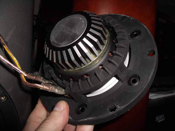

We were fortunate enough to be able to speak with Mordaunt Short designer/engineer Graeme Foy about the design and build concepts that went into the Performance 6. The Performance 6 series was born from the developmental work that went into the newly revamped 900 (Avant) series. Drive units, specifications and engineering were all done in-house at Mordaunt Short. The cabinet design was developed over a period of time as MS designers realized that they wanted something a bit different than could be constructed with traditional wood-based materials. The final monocoque polymer resin cabinet was unique in that curves and varying thicknesses could be used to virtually eliminate resonances within the structure. The cabinet itself is injection molded and the varying thicknesses within gave way to creative acoustical dampening methods. Other enhancement that came out of this style of cabinetry was the ability to literally "float" the drivers off of the front baffle and connect them directly to the rear of the cabinet. If you look at a cross section of the cabinet design you will see how the drivers are secured directly to the rear of the cabinet through a set of six anchor points. This is something that is nearly impossible with a standard MDF cabinet.
baffle The tweeter is a favorite of Graeme and the design team and was specifically developed to address phase issues associated with traditional tweeters and speaker placement. The noticeable venting that exists on the rear of the aspirated tweeter is tuned across 1.5 octaves and arranged in a logarithmic spiral such that these slices of the frequency spectrum are intended to recombine with the originating sound and enhance spatial imaging and overall response. It is designed to have the advantages of adding a back fill tweeter without adding distortion.

Notice the driver is never connected directly to the front baffle.
The midrange driver has a molded basket and CPC driver.
The dual woofers are magnetically shielded with a removable rubber gasket that covers the magnet structure.
Notice how the voice coil attaches to the CPC.
The tweeter passes through the entire enclosure, essentially floating in mid-air.
