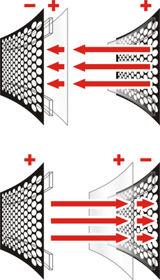

Although it might be easy to just claim that MartinLogan uses black magic to conjure up sound from a 4 foot tall transparent panel, there is a slightly more helpful answer. A thin diaphragm/membrane is stretched tight and sandwiched in between two perforated metal grills, or stators. The diaphragm is only 12 microns thick (that’s 1/8 the thickness of a human hair) and is made of a special material that MartinLogan developed with 3M. The diaphragm is given a constant positive charge while the charge on the stators is reversed thousands of times per second.  By changing the charge on the stators from positive to negative and back again, the diaphragm is pushed and pulled back and forth. As the diaphragm moves back and forth thousands of times per second it rarefies and compresses the air (it “creates” sound). This is arguably an over-simplification as there are a number of special components and complex processes that are involved in production. Luckily, MartinLogan has a great YouTube channel that can help fill you in on some of the gaps.

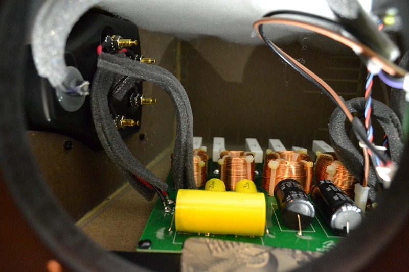

Internal Picture of Theos from Bottom - CORRECT SIZE
Internal shot of Theos from bottom opening

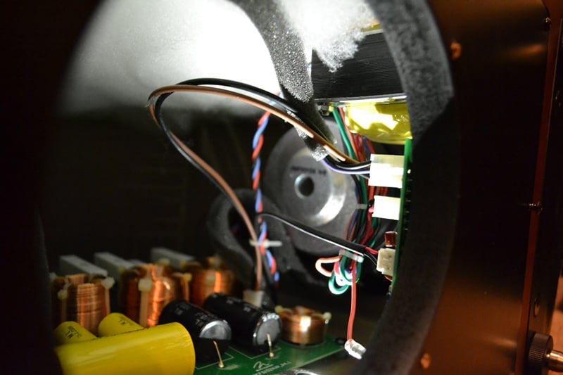

The air core inductors and poly caps for critical circuit paths are high quality and the resistors are mounted on stand offs for better heat dissipation. It’s rare to see this level of detail employed in a loudspeaker crossover but it’s welcomed.
The 8” aluminum bass driver has a bumped back plate to prevent driver bottoming and is vented for heat dissipation. The cabling is twisted pair to minimize interference and wrapped in insulation to prevent them from slapping around inside the cabinet. One side of the cabinet has a piece of batting glued in place.
Theos circuitry and bass driver

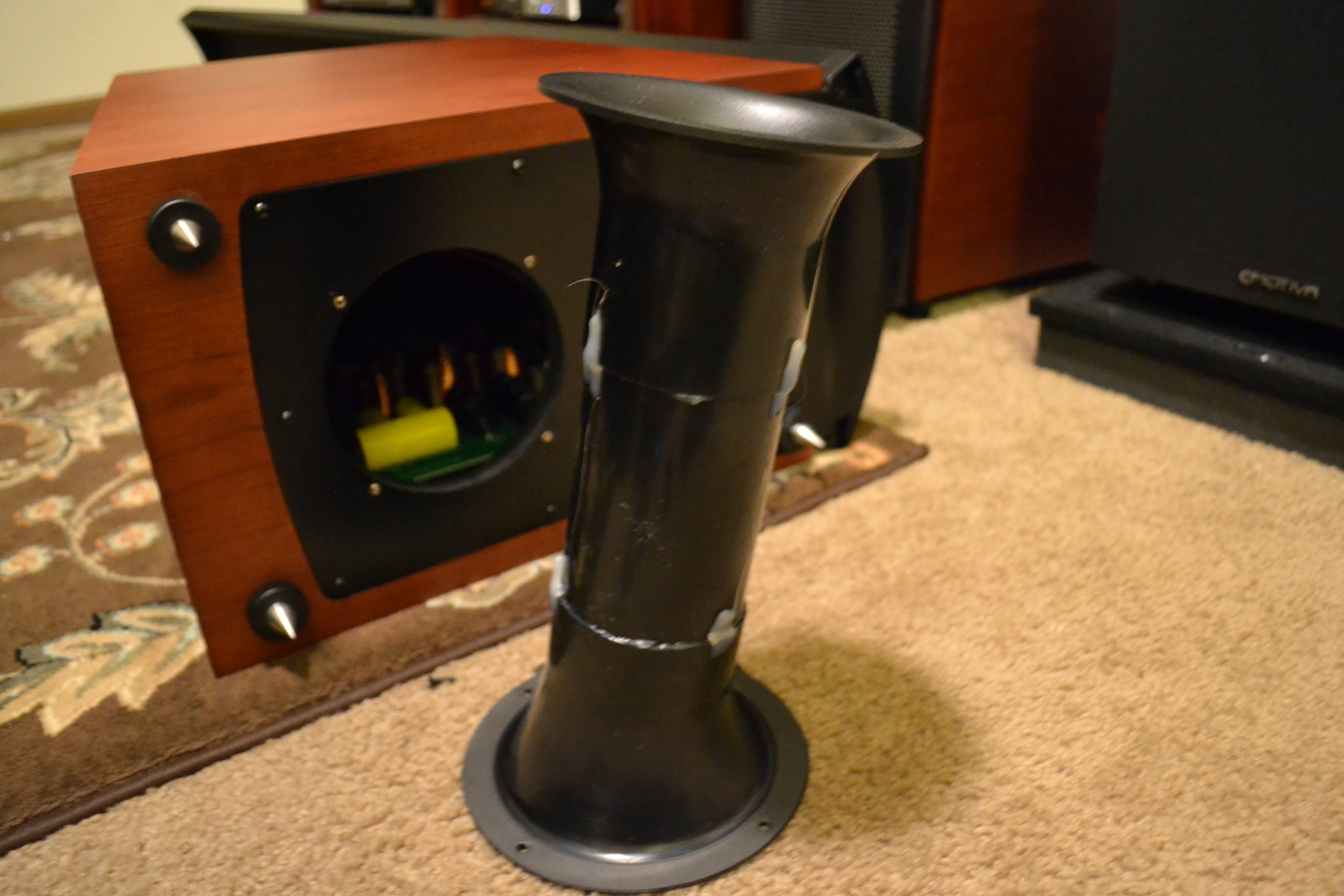

Theos Port Tube - CORRECT SIZE
Theos port tube
The bottom firing flared port is about 3” in diameter and flared on both ends. Many companies cut costs and only flare the side you see. Flaring reduces port noise and placing the port on the bottom of the cabinet and angling it allows for a longer tube than would otherwise not be possible in such a small enclosure. You might notice there is no internal bracing, but it isn’t necessary in an enclosure this size since the panel lengths are significantly smaller than wavelengths of operation of the woofer.
