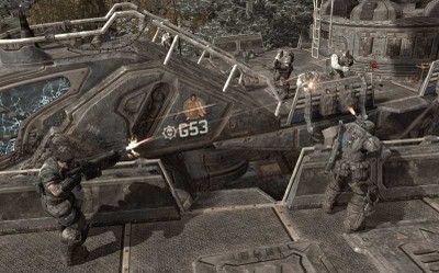

Xbox 360 (multi-channel): Gears of War 2, Rock Band 3
rock band 3Games are a different beast altogether with respect to listening tests, but we felt it only fair that we queue up one of our favorites and see how well the Klipsch F-30 Tower system did with multi-channel directional sound. And what better favorite than Gears of War 2, one of the best games we played last year. During this game there are plenty of opportunities to hear point-source effects and dialogue from each of the speakers in a surround system. And if you want to really enjoy the experience, you just keep moving and spinning to allow the audio to literally encompass the room in a swirling vortex of music, dialogue, machine gun fire and alien attacks. The F-30's horn-loaded tweeters seemed to really take to gaming, and we found that it was super-easy to pinpoint the locations of even off-screen action (which saved our virtual hindquarters on more than one occasion). In one scene, we really loved how running around on a transport and shooting the Locusts on the other side.
Gears War 2 screenshot
