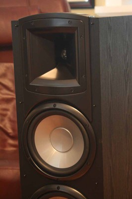

F-30 Floorstanding Speakers ($1050/pair)
Crossover: 1700Hz
Dimensions: 16" x 42" x 9.5"
Enclosure: Bass-reflex, front-firing port
Finish: Black Ash vinyl
Freq. Response: 35Hz-23KHz ± 3dB
Tweeter: 1" (2.54cm) Aluminum driver in 90° x 60° Tractrix Horn
Woofers: Dual 8" (20.3cm), magnetically shielded IMG
Inputs: Dual binding posts / bi-wire / bi-amp
Impedance: 8-ohms
Power: 150W RMS / 600W Peak
Sensitivity: 97.5dB @ 2.83V / 1m
Weight: 60lbs (27.2kg)

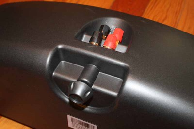

C-20 Center Speaker ($310)
Crossover: 2150Hz
Dimensions: 6.5" x 7.5" x 19.8"
Enclosure: Sealed
Finish: Black pica
Freq. Response: 82Hz-23KHz ± 3dB
Inputs: Binding posts
Woofers: Dual 5.25" (13.3cm), magnetically shielded IMG
Impedance: 8-ohms
Power: 100W RMS / 400W Peak
Sensitivity: 95.5dB @ 2.83V / 1m
Weight: 10lbs (4.5kg)S-20 Surrounds Specifications ($499.99 pair)
Dimensions: 5.5" x 6.9" x 14.3"
Enclosure: Sealed
Tweeters: Dual 1" (2.54cm) Aluminum drivers in 90° x 60° Tractrix Horn
Woofer: 5.25" (13.3cm), magnetically shielded IMG
Impedance: 8-ohms
Sensitivity: 91dB @ 2.83V / 1m
Weight: 7lbs (3.2kg)

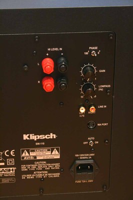

SW-110 Subwoofer ($499.99)
Amp: Bash Digital Hybrid
Power: 200 watts continuous @ <2% THD; 450 watts dynamic
Dimensions: 17" x 14" x 12.5"
Enclosure: Bass-reflex, front-firing slot port
Finish: Black pica
Freq. Response: 28Hz-120KHz ± 3dB
Max output: 113dB @ 30Hz
Woofer: 10" Active non-resonant Woven Fiberglass driver
Inputs: L/R Line-level RCA jacks, L/R High-level speaker binding posts, WA port
Impedance: 8-ohms
Sensitivity: 104dB @ 40Hz
Weight: 35lbs (15.9kg)
