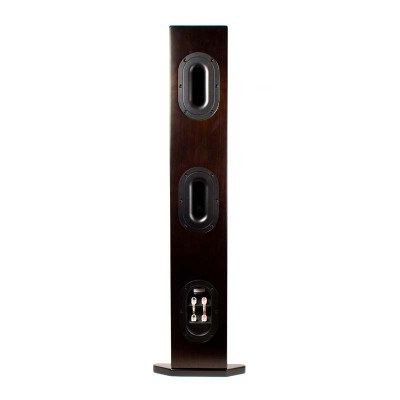

Klipsch WF-34 Back
Klipsch Icon WF-34 Backview - notice the dual oval ports and bi-ampable speaker connections
With three 4 1/2" bass drivers in a 1.43 ft^3 box and dual rear firing elongated oval ports, we have little reason to doubt Klipsch's 50Hz extension claims for this speaker.  The combined surface area of the three 4 1/2" drivers is roughly that of a single 8" driver.  Utilizing smaller drivers allows the manufacturer to create a narrower baffle which is not only aesthetically more pleasing but can offer improved off axis response which can enhance the speakers imaging characteristics.  Klipsch employed a 1" titantium diaphragm compression driver in a 4.5" 80° x 80° round Tractrix(r) horn which is said to widen dispersion across the listening area while also reducing unwanted side wall reflections so the listener can experience more of the direct soundfield.
