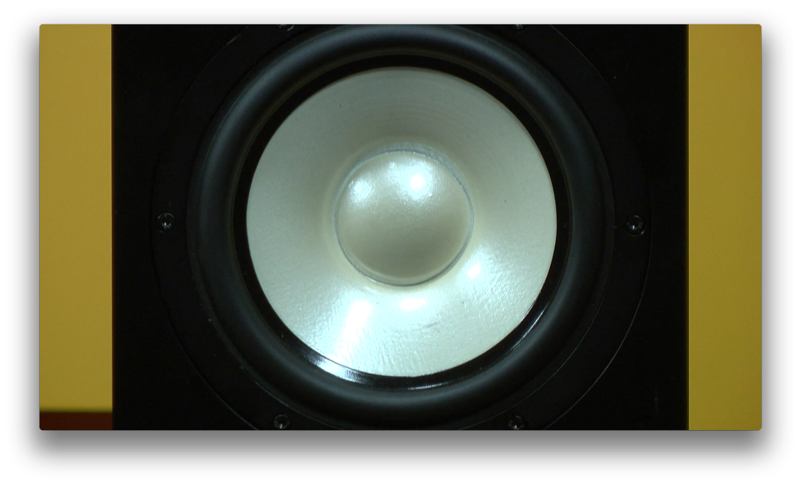

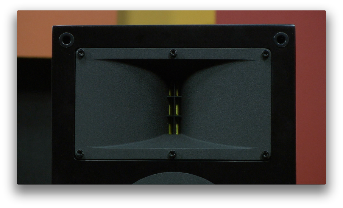

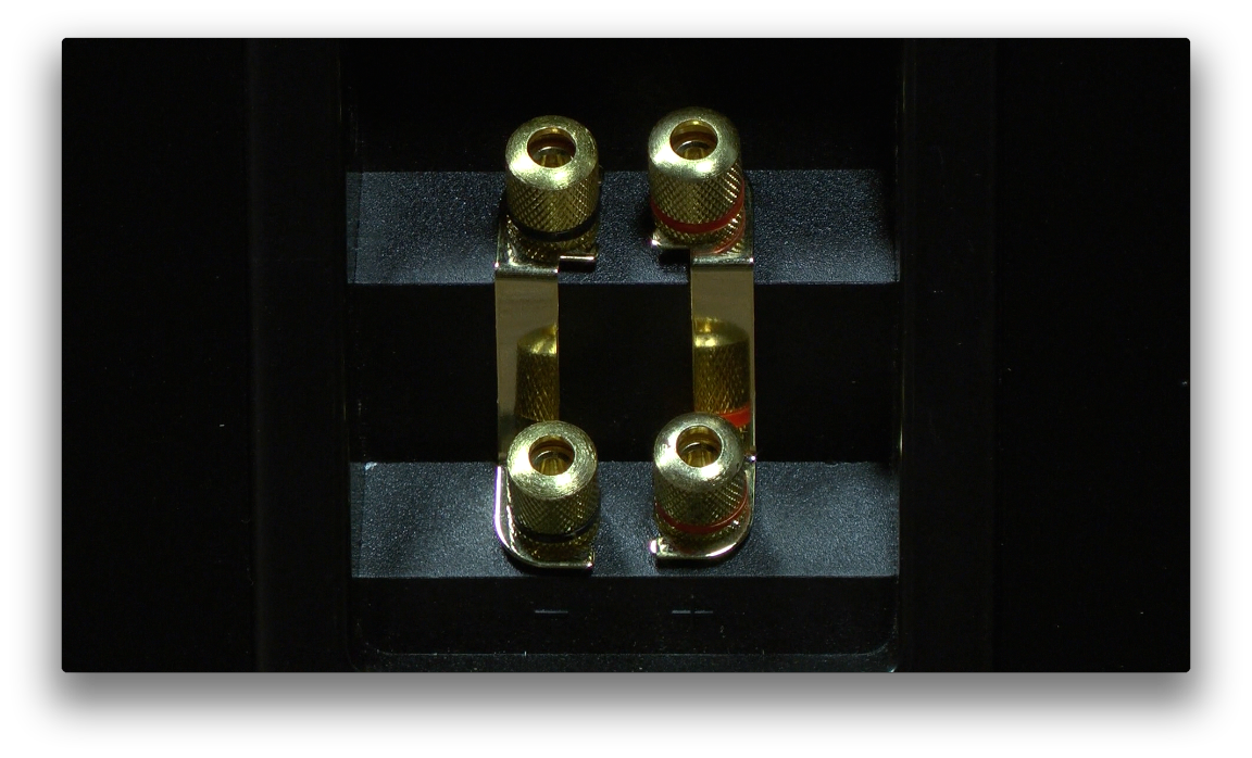

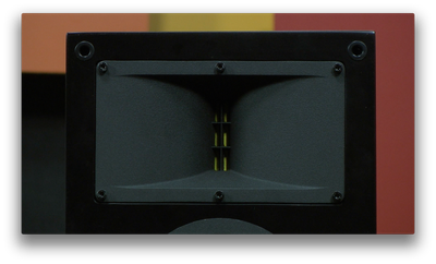

gold binding postsThe Level THREE's incorporate a Kapton ribbon tweeter. Kapton is a material developed by DuPont which remains stable over a wide range of temperatures – like absolute zero to 4 times the boiling point. And while you usually see Kapton in flexible printed circuits or space suits, it also can make a decent material for a ribbon tweeter. The other drivers in the Level THREE include an unusual 2” guided mid-range dome driver and a pair of 7-inch “FCD” woofers. FCD stands for Fabric, Ceramic, Doping. This process combines a fabric woofer with a heat-hardened ceramic and then a polymer coating. The color and texture makes the woofer look like a sort of stiff styrofoam and they're even a little sticky, which doesn't bode well for dust and dirt. But, stiff and light seem to be the key with woofers, and these seem to fit the bill. The front baffle is a little over 5/8” in thickness and the side walls are about the same. The entire interior of the cabinet is open, save for some significant bracing above and below the top mid-woofer. At the bottom is a short, wide port that is actually a tuned transmission line that goes back and up into the cabinet. On the back, the Level THREE's have a pair of basic gold-plated 5-way binding posts that let you bi-amp or bi-wire the speakers.

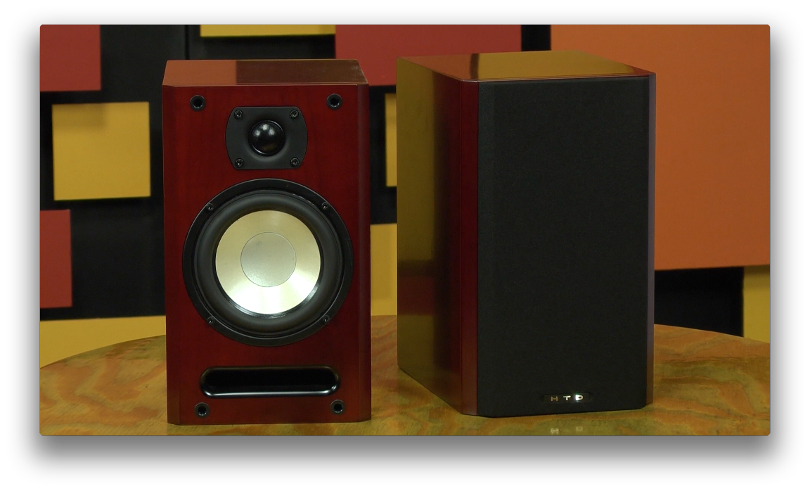

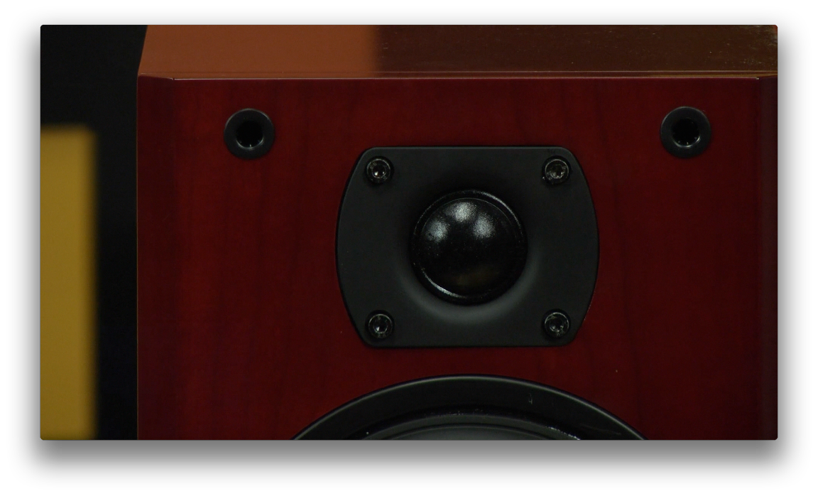

Now – the Level TWO bookshelf speakers... These seem like a great solution for those who want a step down from the larger towers and who want to get a great pair of bookshelfs for the price some companies charge for PC speakers. The Level TWO's come in Black and Dark Cherry and are priced at just $199 a pair. They look pretty good and the veneer is thick enough and nice enough to be fairly durable. The speaker uses a similar transmission line port on the bottom of the cabinet to give it increased bass response and the mid-woofer is the same sort of FCD driver, but with an inverted dust cap. The tweeter looks to be a very basic model and while it offered a good amount of detail, it managed not to be harsh or overbearing.
Level Two speakers
tweeterBoth of these speakers are very enjoyable over long periods of time. We didn't experience an overabundance of fatigue listening to them. For anyone looking to get into a pair of speakers inexpensively, the Level TWOs are a no-brainer. You can build a respectable 5.1 system for under $1000 – and that's with bi-pole/di-pole surrounds, a center channel and a sub. If you want the higher quality of a three-way system, the Level THREEs are respectably priced and it's hard to be anything but excited that yet another reputable speaker company is bringing sub-$1000 speakers into the market. Competition is a great thing.
