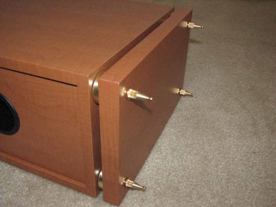

The bottom of the tower speakers are neat in that they have a decorative bottom plate with brass floor spikes. We say "decorative" because they aren't truly outriggers, extending no more than the dimensions of the actual base of the floorstanding SX-HTB+ tower speaker. This bottom plate is also veneered to look exactly like the main speaker and it sits offset by a set of four brass colored discs.

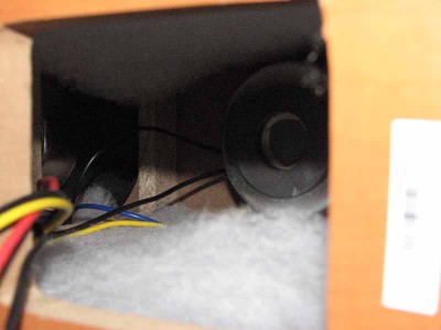

The speakers are all ported - the towers with a plastic cup, and the surrounds and center with a painted cardboard tube. It is this port, and the addition of the second woofer, that gives the SX-HTB+ its unusually low range. The dual 6-1/2" woofers are poly-coated with butyl rubber surrounds that should last a long time. They are shielded, though that is becoming less and less of a problem with new flat panel TVs. We hope the manufacturer drops the shielded magnets in future designs not only for a cost cutting measure but from a performance standpoint. Why waste magnet power (especially for budget minded drivers like these) on an obsolete feature? The 1" silk dome tweeter is of the neodymium variety and is Ferrofluid cooled but not heat sinked as we've seen on higher caliber designs.
Because we're a glutton for punishment, and insanely curious by nature, we next pulled out the crossover and peered inside the cabinet. You can see that they used air core inductors and electrolytic caps. The crossover looks like its a 2nd order HPF (high pass filter) on the tweeter and a 2nd order LPF (low pass filter) on the woofer. We were surprised to see air cores in a system costing less than a pair of Canadian speakers we previously reviewed that utilized only a cap and resistor as their crossover network - and this in a bookshelf speaker costing more than this whole 5.0 system. Fluance also braced the cabinet with additional MDF, and there is some dampening material, though minimal. We also verified that both drivers are active and the system is two-way, so the added woofer isn't separated from the enclosure and used as a (third-way) bass driver. All of the wiring looked to be about 14 gauge and more than sufficiently secured to the drivers and crossover.
