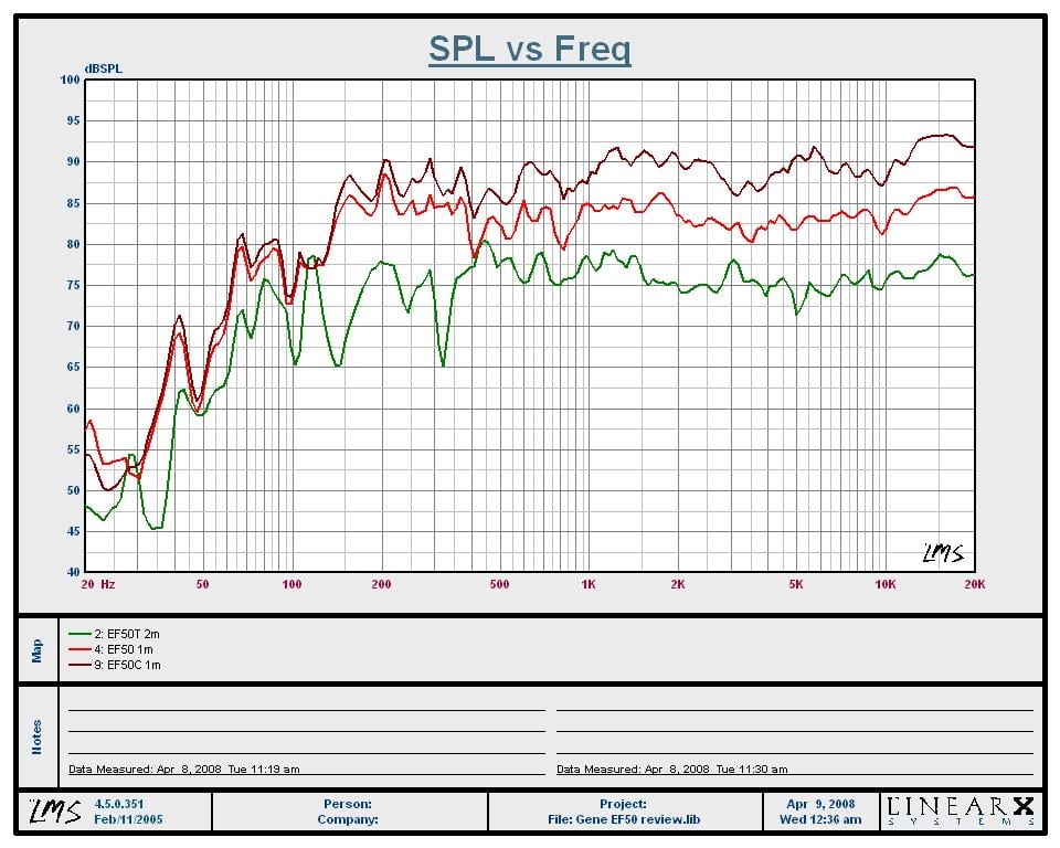

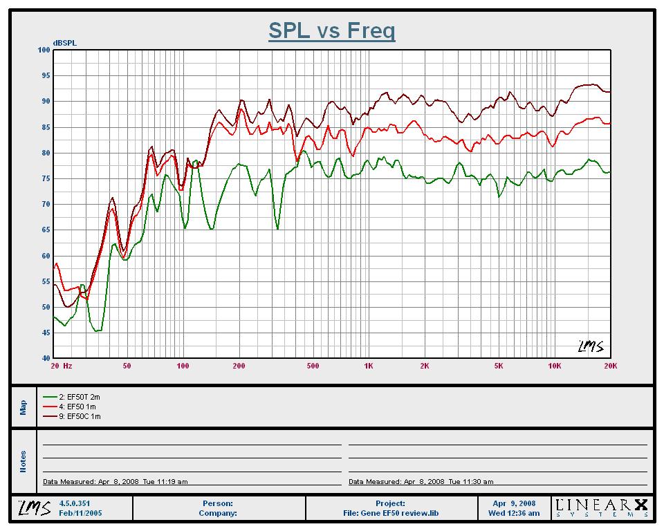

Measurement method:  1 meter on Axis (1/12th Octave smoothed)
The EMP EF50C center channel was horizontally mounted and produced an in-room frequency response of roughly +-3dB from 150Hz to 20kHz.  The frequency response of the bookshelf EF50 speaker was nearly identical. The EF50T tower speaker also measured similarly but with a bit more bass extension below 100Hz allowing for an easier blend with a subwoofer without the need of turning the crossover up too high to make the subwoofer localizable.  Based on these measurements, it’s easy to see that this system plays well together and should provide a seamless blend required for a convincing multi channel experience. This also explains why I thought the system sounded better with a 100Hz crossover rather than 80Hz.

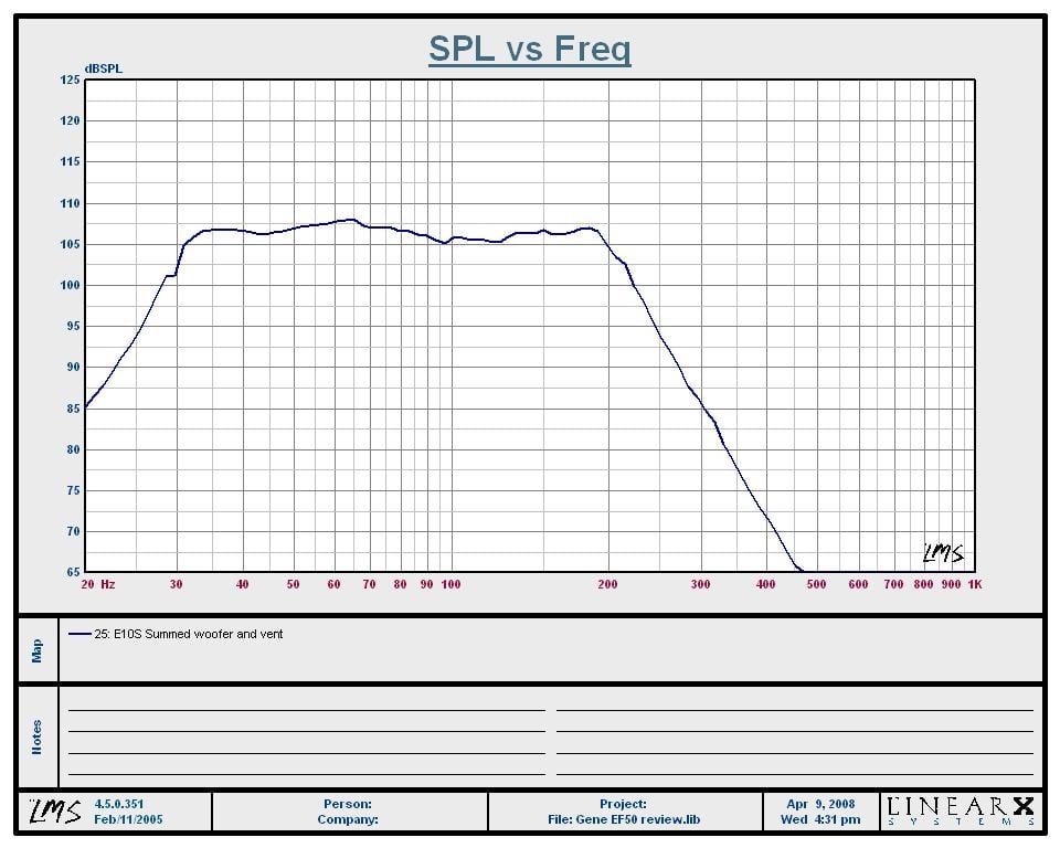

EMP E10s Sub Summed Woofer and Port
The EMP E10s subwoofer has a very flat response from about 200Hz down to 33Hz with the -3dB point around 30Hz (exactly as the specifications state). While the sub won't provide some of the subsonic slam that other, larger, ID subs will, the tradeoff is a small form factor and easy placement. For so small a sub, it has a lot of slam and great linearity.
