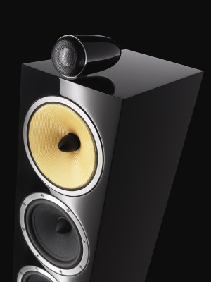

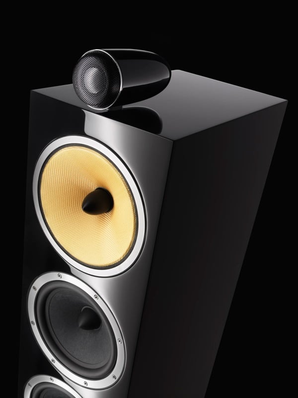

Well, B&W couldn't leave well enough alone. While the old flagship of the CM line, the CM9, retails for $3k, the new CM10 will run you $4k a pair. B&W hasn't gone too overboard with the design. The big change is that they've offloaded the tweeter onto the top of the speaker reminiscent of their other, much more expensive, offerings. B&W promises the CM10 tweeter will have better imaging and dispersion for a more natural, spacious sound. The tweeter itself hasn't just been isolated, it has been improved and upgraded. It is a 1", dual-domed aluminum driver. The dual-domed design prevents the voice coil from distorting at higher frequencies staying stable up to 38kHz.

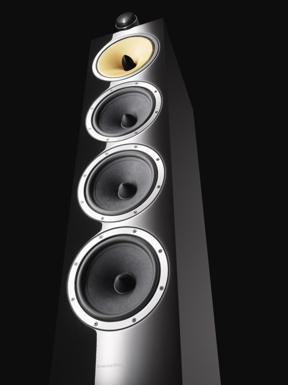

The fun thing is that B&W has kept the height of the CM10 cabinet exactly the same as the CM9 giving extra room for an additional woofer (though the CM10 is 1.6" deeper). The CM10 features a 6" woven Kevlar cone FST midrange and three 6.5" paper/Kevlar cone bass drivers (up from two in the CM9). This takes the -3dB point on the CM10 down to 45Hz with the CM9 falling off 11Hz higher. Another upgrade is that the 6" Kevlar FST midrange is completely decoupled from the rest of the speaker by a drawbar mechanism, like what is found in the 800 Series Diamond speakers.
