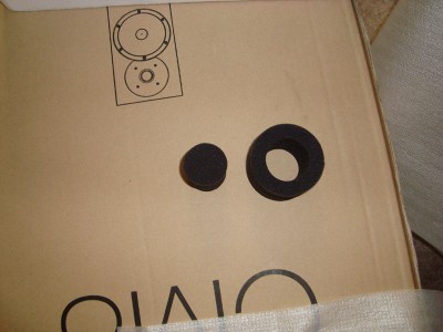

Which brings us to the next subject: those foam bass plugs. As stated before, these are a two-part cylindrical foam “plug” that fit into the rear bass Flowport™. You can effectively transform the CM8 into a sealed system by using the entire plug, or you can remove the center section of the plug and get a quasi-combination of sealed and ported performance. As shown in the manual, using the plugs reduces the bass output (a higher 3 dB down point) and makes the LF rolloff more shallow. Using the full plug makes the CM8 behave like a sealed system, with a 12 dB/oct rolloff and a higher 3 dB down point than when the port is fully open.
Why would anyone want to do this? The low end of the speaker is so correctly engineered and clean-sounding as a bass reflex system that to arbitrarily change it into something non-optimal seems idiotic. About the only worthwhile use I can see is to change the CM8’s LF rolloff to 12 dB/oct to match up with THX-spec pre-amps when using a subwoofer. THX specifies that the “satellite” speakers have a 2nd-order rolloff (12 dB/oct) to combine properly with the 2nd-order LP on the subwoofer. But for full-range music use, as I was using them, the port plugs served no useful purpose whatsoever.

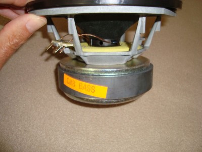

AcuDefTechGuy posts on August 03, 2012 09:44
Just more info:
CM8
Cartons = $54 each speaker
FST midrange = $123 each driver
Tweeter = $147 each driver
Woofers = $ 71 each driver
Plinth (body) = $117 each speaker
Crossovers = $163 each speaker
Grilles = $100 each speaker
