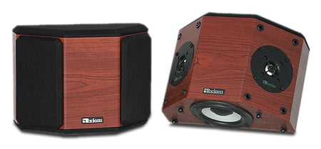

QS8 The Axiom QS8 surround speaker is yet another unique design. It incorporates dual tweeters mounted on a trapezoid front baffle. The tweeters are wired in phase. The QS8 also has dual midranges, one mounted on top and one on the bottom that are wired in phase. This unique driver configuration produces two effects: it makes the speaker have a very wide dispersion area and it creates a very diffuse soundstage.

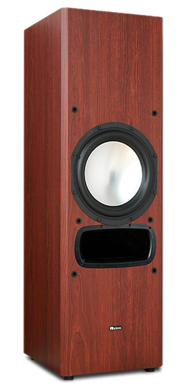

EP600And then there is this to say: the Axiom EP-600 differentiates itself from the norm. This is an understatement. This subwoofer walks among the giants, weighing in at 100 lbs and standing 46 inches tall. It truly is intimidating. The 12-inch aluminum woofer is mounted in the center of the front baffle: below that you will find the vortex port and the small rectangular Axiom badge.

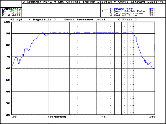

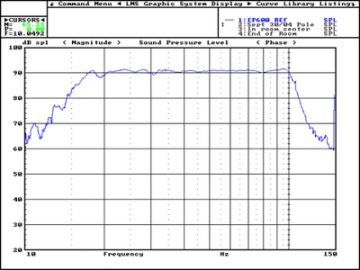

What more do we need to say - one look at the frequency response of the EP-600 and you can see that this is a very capable subwoofer. Look at how flat the response is between 20Hz and 100Hz. Also note the low-end extension to about 15Hz.
