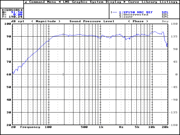

The VP-150 has a pretty flat frequency response. There is a slight hump between 12kHz -17kHz. Also note the effective low frequency cutoff of about 80Hz.

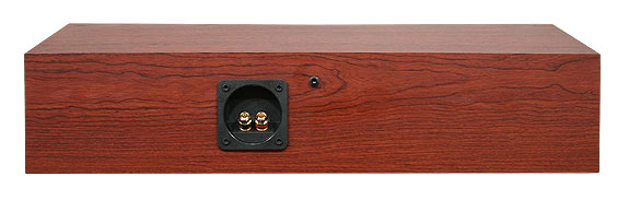

clip_image004_038.jpg Around the back of the VP-150 you will find very high quality five-way gold plated binding posts and the mount hole for the optional wall bracket as shown below. A look inside the VP-150 revealed very good speaker components and build quality. The enclosure is constructed from 3/4" MDF and is lined with polyfill. 18 AWG high strand count copper wire is used from the crossover to the speaker spade connections. The speaker's woofer component is of high quality aluminum and the midrange speakers have steel baskets, large motor structures, and shielded bucking magnets.

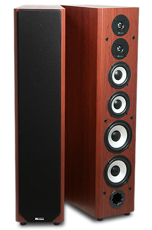

clip_image010_004.jpgThe M80ti floorstanding speaker has another interesting design. As far as I know, the design is not replicated in any current loudspeaker currently on the market. The Axiom M80ti has dual tweeters mounted in tandem on the top of the front baffle, below that there are dual midrange drivers and dual woofers.
The drivers used in the M80ti are the same type used in the VP-150 with the exception of displacement. This insures very similar sonic signatures for seamless transitions between the center speaker and front main speakers.
All drivers used in the Axiom M80ti are active and they are all recessed into the front baffle. Many loudspeaker manufacturers use multiple drivers in their designs in an active/passive-radiator configuration. All of the drivers in the M80ti 舗 s are active. The first of three ports is mounted on the very bottom of the front baffle.

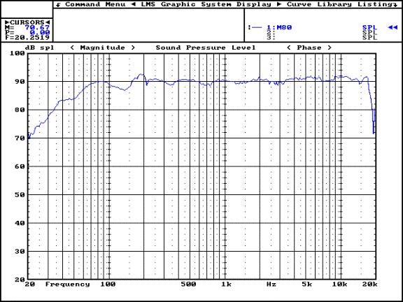

m80_back As you can see from the above 1 meter frequency response, the M80ti measured very well and has a relatively flat anechoic response. The M80ti has an effective low frequency response of about 40-45Hz which is somewhat masked in the measurement since anechoic chambers bass response below 85Hz begin to taper off.

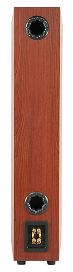

A peek around the back of the Axiom M80ti revealed that these speakers can be bi-amped, due to the incorporation of dual 5-way binding posts. These speakers are also bi-wireable, however, in my opinion this method of termination will yield no appreciable gain in performance. Unless you have a very long run of speaker wire and you want to double up the gauge of wire to compensate for the long distance, there is no audible benefit. The remaining two ports are located on the top and bottom of the enclosure as shown in the photo.
