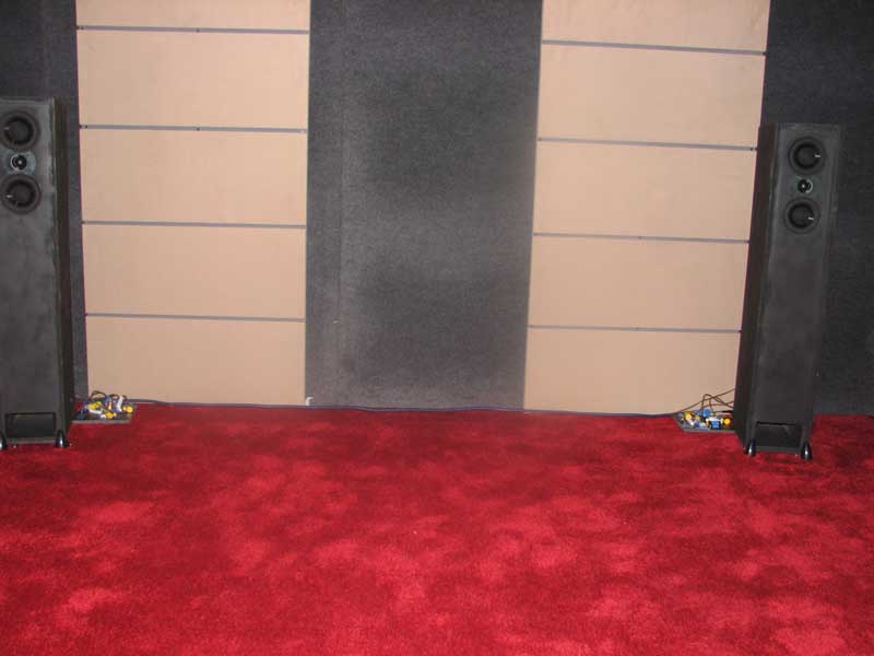

H-Pass-1 Demo
Atlantic Technology H-Pass-1 Demo
Listening Impressions
We were presented with a demonstration of the HPAS-1 floorstanding prototype which had unfinished cabinets and the crossover boards laid out on the floor and jury rigged to the speakers.  They played musical score sample tracks from various movies (most memorably from ET).  The low end bass extension was impressive.  We would have never imaged a pair of 4 1/2” drivers were capable of pressurizing the room to provide good tactile response.  I was curious to hear music with sustained bass and acoustical instruments which they obliged towards the end of the demo.  With normal program material, the bass extension seemed less pronounced but the system remained clean with no hint of woofer distress.  It seemed the benefit of this enclosure was most notable towards the lower end of the bass spectrum near its tuning frequency.
