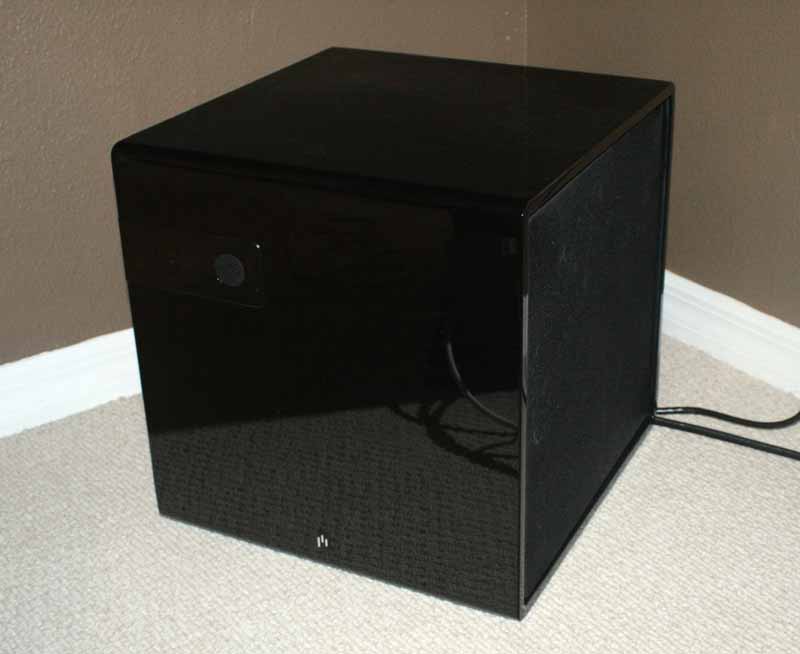

bravus-10D-angled-2.jpgThe build quality of this sub really surprised us. Not in the "wow, they actually did something right" sort of way, but the "holy cow, our readers really need to start checking these out" sort of way. So many other Internet brands get recognition for subwoofer performance and build quality, but I think we might need to take a second look at the 12D as a new stand-alone contender. The sub has two 12-inch aluminum high excursion drivers with rubber surrounds that were durable and nicely stiff. Aperion supplies Bravus 12D owners with 4 metal carpet spikes and footers, 4 rubber feet, a remote control and grill removal tool. The AC power cord is removable, making it easy to move the sub around if needed or, if you're so inclined, you can experiment with all those esoteric power cables that cost a ton of money and typically do anything beneficial.

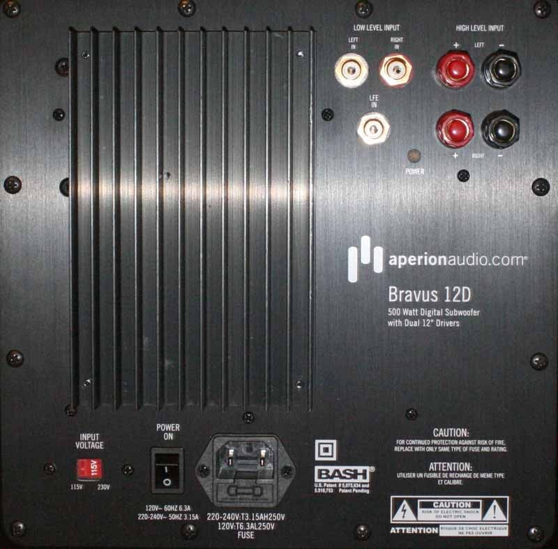

A 500 watt rms BASH amplifier drives the system and the sub supports line level and speaker level inputs. There is also a dedicated LFE input which will save many users the need for a Y-cable splitter. On this sub the left-right inputs are for full range line-level signal, perfect for those who have legacy receivers or integrated amplifiers without a subwoofer output.
What you see here is it - other than power, the rest is via software control
