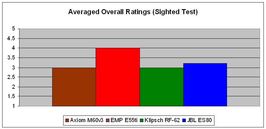

Since time was limited, I only asked each listener to offer a final overall ranking for each speaker while listening to them without the grille cloth coverings.  The speakers were level matched exactly how they were done in the blind testing.  One of our trained listeners was unavailable for the sighted tests which would have likely boosted the EMP and JBL ratings since he scored those highest among the four speakers during the blind tests.  The results were averaged are tabulated below.
 Sighted Results
Overall Ratings for Sighted Tests
In this round of testing, the EMP E55ti's appeared to come out on top while the Klipsch RF-62's and Axiom M60v2's ratings dropped most dramatically.  I believe the most significant reason for preference changes in the sighted testing had to do with restoring the tonal balance of all of the speakers once the lossy grille cover was removed.  Aesthetics may have also played a factor though nobody commented on the appearance of any of the speakers in the comparison since they were sitting so far away and focused more on what they were hearing while note taking.

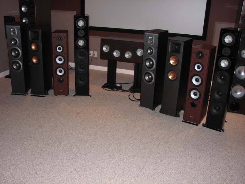

Pinnacle BD 1000 Honorable Mention
Pinnacle-BD1000.jpegPinnacle BD 1000 Specifications Page
About a week prior to this faceoff, I contacted Pinnacle Loudspeakers as a fall back in case the JBL's didn't come through. The JBL products did arrive as did the Pinnacles but on the day of our event when we were already knee deep in our listening tests.  We put them aside and pressed on.
The Pinnacle BD 1000's retail for $1300/pair and are a 3-way 4 driver tower speaker consisting of a 1" silk dome tweeter, two 5 1/4" woofers and one 5 1/4" phase plug midrange.  Their claimed frequency response is 34Hz to 20kHz +-3dB with 200Hz and 5kHz crossover points.  Their rated sensitivity is  88dB @ 1 watt/meter with an nominal 8 ohm impedance.   I must admit my first impression was "there is no way these little speakers could be competitive with the other four under test".  At the end of the day, our listeners were itching to hear them nonetheless.  We unboxed them and setup some brief sighted listening tests.  Everyone, myself included, was impressed by their performance.  The bass was deep and well extended, the mids were articulate and the highs were crisp and energetic.  These speakers portrayed a sound that bellied their diminutive size.   Although we didn't critically listen and compare these speakers to the others in this Faceoff, I believe they would have done very well. I requested that Pinnacle allow me to hold on to these samples longer so I could write up a formal review.
