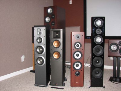

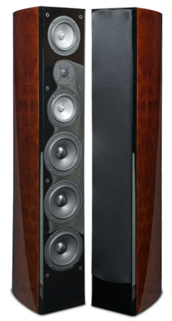

EMP-55ti.jpgWhile EMP is a relative newcomer for an online speaker company,  the same people that design the highly esteemed RBH Sound products are responsible for the EMP.  Rest assured there is trickle down technology shared and benefited to EMP from RBH Sound.  The E55ti was the largest and least expensive speakers in this comparison.  Standing a tad over 4 feet tall, it also had the most drivers (6 total) including three 6-1/2" bass drivers, two 5-1/4" midrange drivers and a 1" silk dome tweeter.  The top half of the E55ti's have an MTM driver arrangement which helps to control vertical dispersion while also providing a lot of dynamic range since multiple drivers are dedicated for the midrange frequencies.  The soundstage thrown off by these speakers is truly impressive and has to be heard to be believed.  The E55ti was the second most efficient speaker in this comparison and employed 120Hz and 3kHz crossover frequencies making it a true three-way design.
Despite the fact that the E55ti has three bass drivers, it doesn't seem to play as low as some of the other products in this comparison (namely the Klipsch and Axioms).  EMP chose maximum output over extension which came in spades when I tested them in my 6,000 ft^3 room at ear bleeding levels and wasn't able to bottom any of the drivers or cause audible distress in the critical midrange frequencies like I heard with some of the other speakers in this comparison.  They are also a super easy load for any amplifier to drive as the impedance doesn't drop below 8 ohms at low frequencies.  Although these speakers aren't bass anemic, I feel they are best used in conjunction with a subwoofer. This had me a bit concerned in this comparison since we were running all speakers full range without the use of a powered sub.   I bugged EMP enough to have them make a running change to the bass drivers which they claim will lower the resonance frequency of the driver by 10Hz to produce stronger output at its tuning frequency (50Hz) and more usable low end extension.  Expect a formal review of these speakers when the driver updates become available.

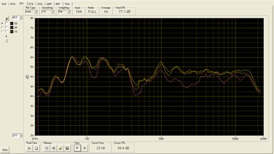

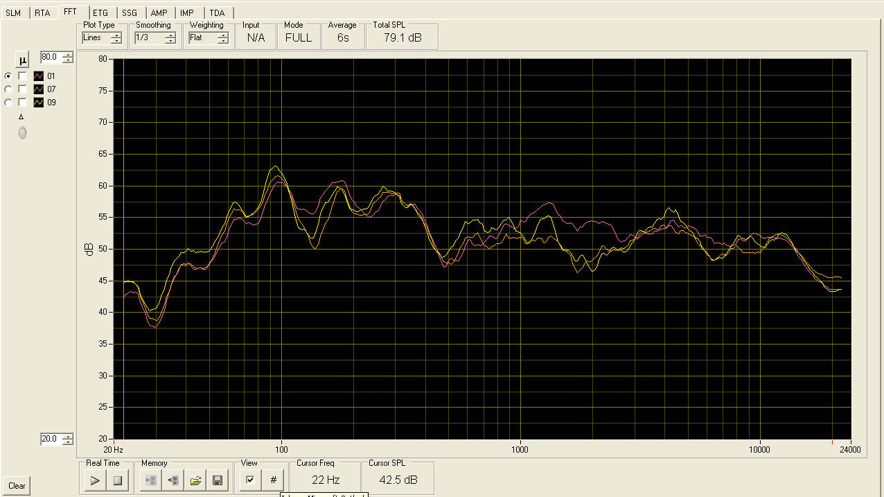

EMP E55ti In-Room Frequency Response at Primary Listening Position
I measured the E55ti's for all three test trials.  The dip at 400-500Hz is caused by floor bounce which is a measurement anomaly. The variations between the three measurements were due to positional differences whether they were located in the marked area closest to the left wall or further.

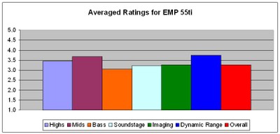

EMP E55ti Listener Comments for Blind Tests
With EMP directly compared to Axiom
Comments from trained listeners:
  • Very natural life-like sound with pristine midrange and smooth top end.
  • Fuller sound, more natural and pleasing blend of frequencies than [the] other speaker.
Comments from other listeners:
  • Lacked details in highs with average imaging and soundstage.
  • Female vocals were deeper but other speaker had more impressive soundstage
  • Great vocal clarity but bass was boomy.
  • Bass was tighter and drum solo sounded more life-like and real than the other speaker but overall sound was somewhat mushy.
