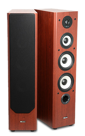

The Axiom M60s have been around for quite some time.  Over the years the company has continually refined its performance which we can partly validate with their latest v2 edition that no longer employs electrolytic caps in series with the tweeter. Instead, they've been replaced with less lossy poly ones.  Axiom has also refined the tweeter performance in their latest series and eventually plans on adding magnetic grilles and completely aluminized cones so all of the mid and bass drivers will appear completely silver.  The review samples sent to us were actually early V3 versions without the magnetic grilles or silver cones.  Axiom told us the performance of these speakers is identical to their latest V3 offering however.
The M60v3 employs 4 drivers with a 1" titanium tweeter, 5.25" midrange and two 6.5" woofers.  They are triple vortex ported (2 rear / 1 front) with a claimed extension down to 37 Hz (-3dB).  The tweeter has a 2kHz 12dB/octave HP filter while the midrange has no crossover at all relying on the natural acoustical rolloff of the driver (12dB/octave) and small sealed enclosure to provide more bass output above the tuning frequency of the ports.  Unfortunately since the midrange has no HP filter, we noticed at high volume levels, the little driver was stressed  though we never heard it actually bottom out which was a testament to their driver design. It's important to note that anyone wishing to use these speakers in a large room with a huge appetite for high SPL levels should consider high power amplification over a receiver to power them as these speakers can handle it.  Luckily I was using the Axiom A1400-8 power amp which has enough current drive to push a train, but I wonder how many potential buyers would be using such a beast for a sub $1000 speaker system.
Overall, I found the Axiom M60v3's to have a warm and pleasing sound with excellent bass extension second only to the Klipsch RF-62 in the bass extension but not necessarily in accuracy.  Depending on program material, I found the midrange was a bit recessed and chesty sounding on male vocals with notable break up at high sustained output levels, but the highs were quite detailed producing a very pleasing fullrange sound.  It was a sure bet to me that these speakers would do well in the listening comparison among our panel of listeners.

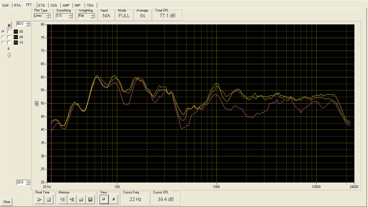

Axiom M60v2 In-Room Frequency Response at Primary Listening Position
I measured the M60v3's for all three test trials.  The dip at 400-500Hz is caused by floor bounce which is a measurement anomaly.  The dip in the red trace across the entire frequency spectrum was because I forgot to turn on both channels when pulling that measurement like I did with all of the other measurements.
