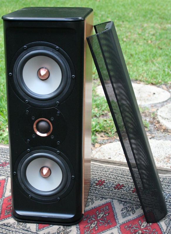

snell_grillOff.JPGAs I mentioned, the one thing I was really worried about with the Snell Acoustics LCR7 XL was their height. Looking at them, I thought I might have to worry about them falling off my Studio Tech stands. While I can mass-load the stands, I haven't simply because I have to move them so often. While the Snells only weigh 26lbs, they are solid and well balanced. When I placed them on the stand, it was as if they became part of the stand! I honestly forgot they were bookshelves as I was climbing behind them to get to cables and other gear (and thrown Legos). Never once did they falter, tip, or even hint that they might go over. This is surly an interaction between the sturdy stand construction and the Snell even weight distribution.

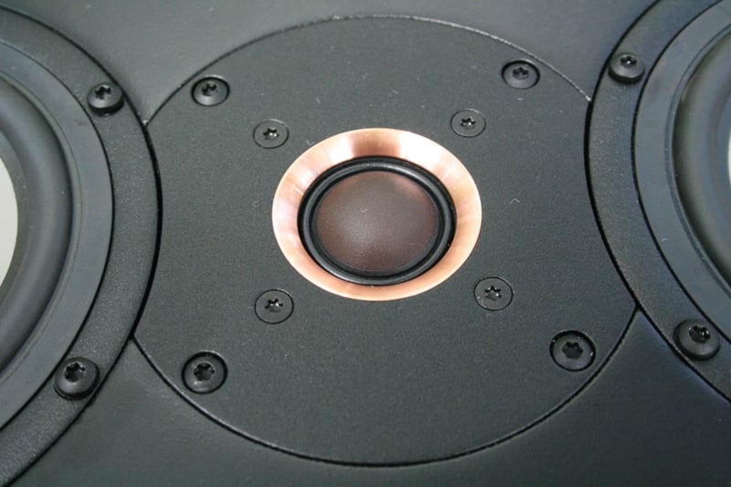

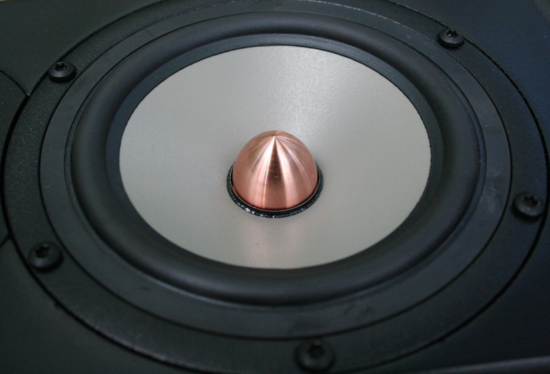

snell_tweeter.JPGWhile I was reviewing the Snell Acoustics LCR7 XL in a 2-channel configuration, I couldn't help but wonder what they would sound like in a full surround setup (or at least three across the front). While I've often used review speakers in conjunction with my reference speakers, rarely do I find them so outclassed as I have with the Snells. My RBH 515C center channel has melded well with most other speakers. In fact, the only time it hasn't is when the other speakers couldn't keep up. With the LCR7 XLs, it was obvious that my RBH center channel speaker was outclassed. Of course, with the RBH a fraction of the price, you'd expect that. But I've reviewed speakers in this price range before and never noticed so much of a difference. The LCR7 XLs were just so much clearer and more dynamic.

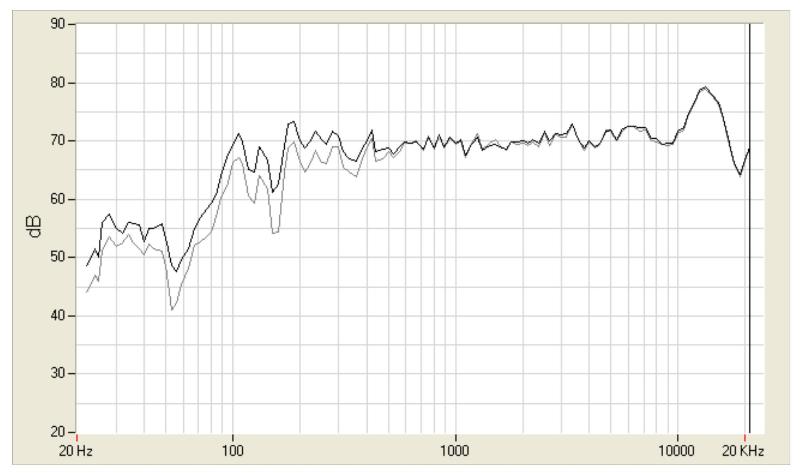

Snell LCR7 XL 1 Meter Frequency Response (1/12th Octave) On Axis
Note - this is NOT a 1 watt measurement
As you can see, the LCR7 XL measures incredibly flat on axis except for a bump around 15kHz with a fairly dramatic dropoff below 80Hz. Snell specs these speakers to 75Hz which seems around right from these measurements. The high end bump was a little disconcerting however. The lighter line is with the boundary compensation turned on. It does a very smooth job of reducing the bass output below 500Hz by about 3dB.

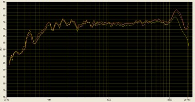

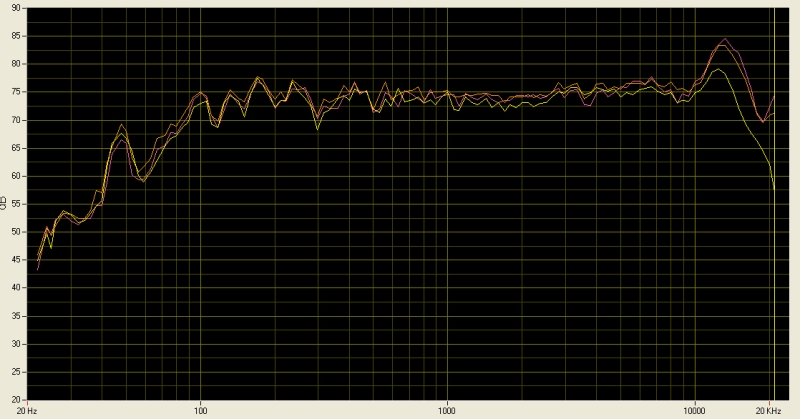

Snell LCR7 XL 1/2 Meter Frequency Response (1/12th Octave)
Pink - On axis, Orange - 15 degrees off axis, Yellow - 30 degrees off axis
What's important in this graph is again how flat the frequency response is between 80Hz and 10kHz but also how it flattens out with the 30 degree (yellow) line. I did a few informal tests with the mic around 4" away from the speaker and at 35-40 degrees off axis, the response was nearly ruler flat all the way up to 18kHz. Off axis is definitely where you want to be with these speakers unless you like a little more high end energy or have lost a little hearing in that range.

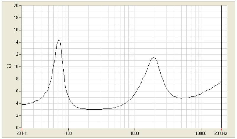

Snell LCR7 XL Impedance
The Sencore consistently measures impedance one ohm low. I measured the impedance at the terminals at about 4 ohms which lines up well with the Sencore and Snell's specs.
