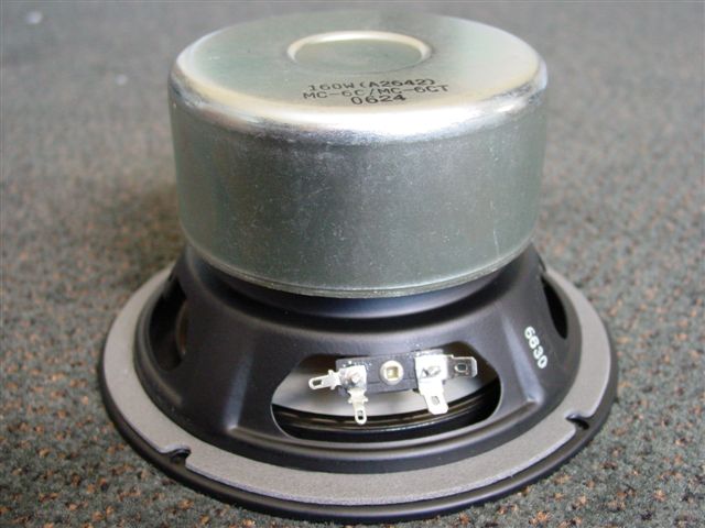

The 6 ½” aluminium cone woofer is very similar to the driver used in their Signature Series except the basket is stamped rather than cast aluminum. While this is certainly a design compromise over a good ole cast basket, it’s an understandable one. Let’s not also forget so many speakers from other brands exclusively use stamped baskets on even their most elaborate designs. RBH Sound still employed many of their tricks from their Signature line woofers including bumped backplate on the magnets, polyimide film voice coil formers for higher power handling, silicone coated aluminum cones and butyl rubber surrounds to minimize resonance and ringing. Also note this driver is fully shielded and the magnet structure is encased in a metal can to reduce any stray fields. Many manufacturers tend to skimp here and only provide the opposing magnet without the metal can.

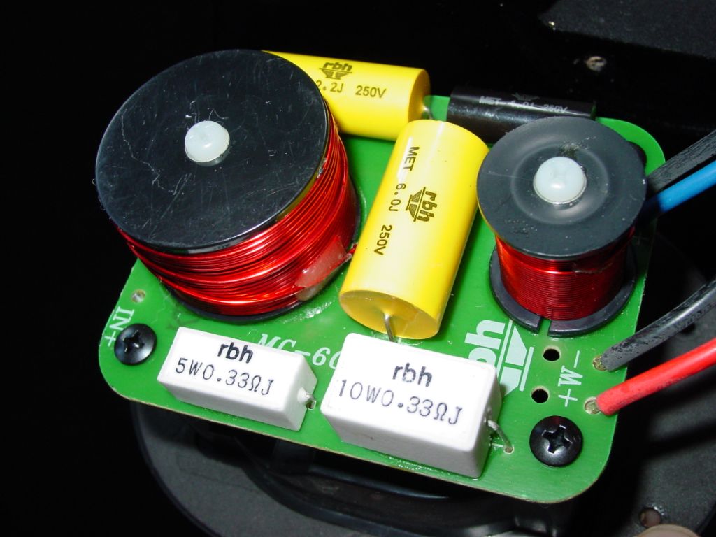

Crossover
As usual, RBH doesn’t skimp here like so many other manufacturers do. You won’t find any cheap electrolytic caps in series with the tweeter. Instead you will find audiophile polypropylene capacitors, ceramic resistors and air core inductors.
The speaker design relies on the electrical crossover network and natural acoustical roll off of the drivers which the overall response can be best described as a 2nd order Linkwitz-Riley design which produces a -6 dB crossover point to achieve a maximally flat amplitude response.mc6cback.jpg

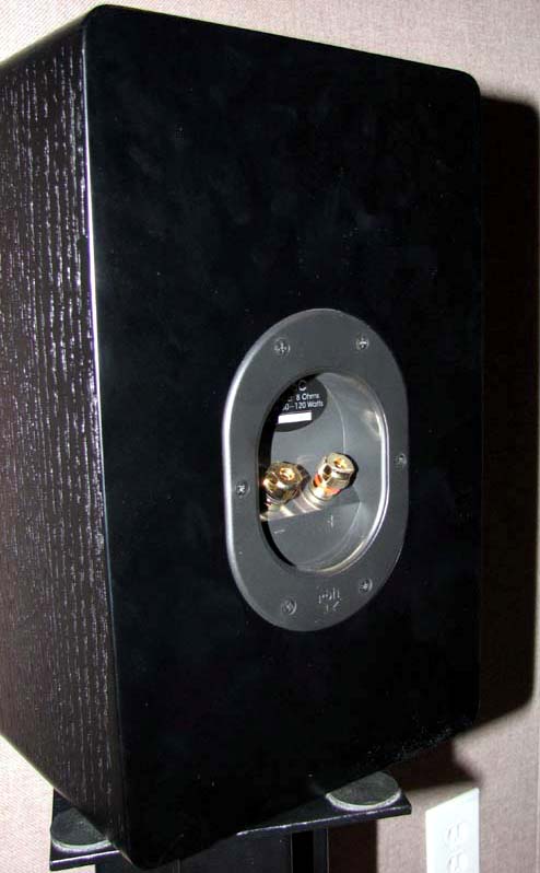

The Backside
The MC-6C has a very clean back end. RBH employs a 5-way gold plated binding post utilizing indented terminal lugs. I am not the biggest fan of these binding posts since they can be quite challenging to turn on thick gauge wire as they are closely located. Personally, I use compression banana plug terminations so it becomes a moot point. The completely rounded cabinets look great at any angle but, of course, look sexiest from the front because of the shiny aluminum drivers and molded baffle.
