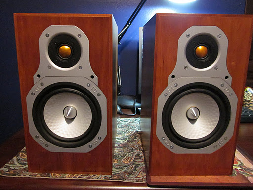

As usual, I could not resist dissecting these speakers to find out what makes them tick. I had to search for a special hexagon screwdriver in my garage to remove the screws from the woofers and tweeters. I suppose Monitor Audio choose to make this chore a little more difficult than normal to prevent people like me from what I was doing. In any event, I took great care in removing the drivers, and I don't recommend trying this at home.
Monitor Audio GR-10 Woofer (left pic) & Tweeter (Right Pic)
I
was quite taken by the build quality of the midbass
RST C-Cam driver. It incorporated a heavy powerful motor
structure and extremely rigid non ferrous metallic basket.
The cone material employed was perhaps the most rigid
I have ever seen remaining extremely stiff while I gently
pressed the edge of the cone from the back of the driver
with my finger. Most cones of lesser design flex considerably
when I apply this test.
The signature Gold Dome tweeter appeared to be very similar to the one used in the Studio series, although David informed me that some tweaking has been done to enhance performance further.
The cross-over network is of a more sophisticated design that I am used to seeing from Monitor Audio. It is not just a conventional LC network. Some shelving circuits and attenuation pads have been added to better blend the drivers. All components are of high quality of course (IE. Air Core inductors, Metallized Polyester Capacitors, etc)
Monitor Audio used high quality silver speaker wire to connect the drivers and cross-overs. This is just another example that they paid very close attention to detail with this design.
Monitor Audio offers a very impressive package with
the new GR-10 bookshelf speakers. I have had extensive
listening experience with other Monitor Audio products
for over a decade and feel that these are their best
sounding and most visually appealing series. Monitor
Audio has managed to create an excellent sounding, finely
crafted, and relatively affordable bookshelf speaker
system that rivals many of their more costly competitors
solutions. My only minor gripe is mostly a cosmetic
one. I wish they would have rounded off the corners
of the cabinets as I feel it would have made these speakers
even more visually pleasing and possibly added a tad
bit better imaging of the tweeters by reducing lateral
baffle surface area and reducing tweeter diffraction.
In any event, the GR-10's are a must audition if a small,
attractive and high performance bookshelf speaker system
is what you are after. They are an excellent successor
to their flagship discontinued Studio Series and should
provide countless years of musical enjoyment to even
the most critical listeners.
