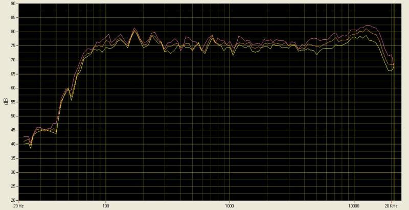

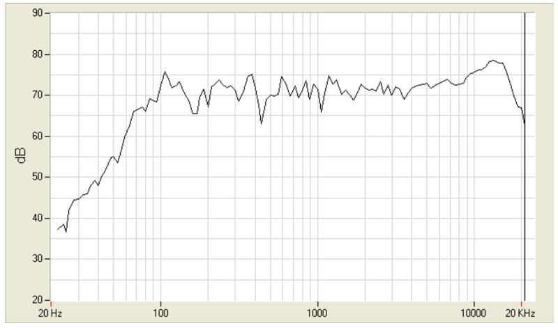

For laboratory measurements I used the Sencore SP395A FFT Audio Analyzer and a Sherbourn 2/75B amp. I measured the Infinity P162's in room on and off-axis frequency response with 1/12th octave resolution. The first thing I discovered is that the sweetspot for this speaker is quite a bit lower than the generally recommended tweeter level. Many speakers measure best between the tweeter and woofer but the P162s measured best at woofer level or a bit lower. From about 4" away, dead center on the woofer was the flattest response with tweeter level showing a huge bump in the high frequency range. From a farther out, the flattest response was lower - about the level of the port or a touch higher. It seemed apparent to me that Infinity was putting a lot of sizzle into this speaker based on market demands at this price point and the typical sales channels they are offered to. Aside from the hot top end response above 10kHz, the speaker measured fairly linear and displayed good bass extension given the enclosure and woofer size.
P162 1 Meter Frequency Response (1/12th Octave) On Axis
Note: this is NOT a 1 watt measurement

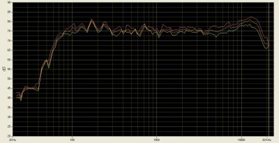

P162 1/2 Meter Frequency Response (1/12th Octave)
Pink - On axis, Orange - 15 degrees off axis, Yellow - 30 degrees off axis
As you can see, the response of the speaker is fairly uniform with a bit of a bump in the higher register - especially on axis. This is a speaker that should be positioned with a minimum of toe-in with the ear height no higher than the middle of the woofer.

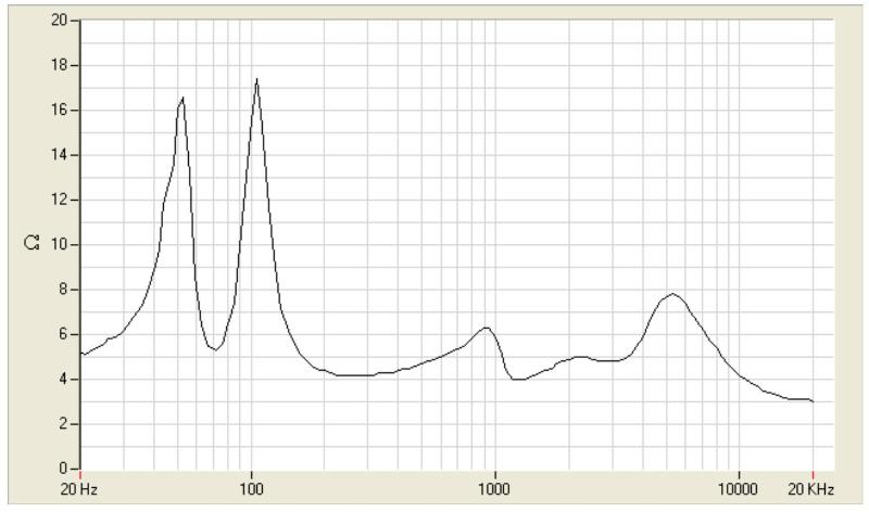

P162 Impedance

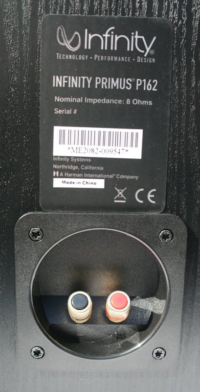

The Sencore consistently measures impedance one ohm low. I measured 5.5ohms at the terminals which lines up pretty well with the Sencore. Infinity claims 8 ohms and while not technically true, the benign impedance profile should match up well with most any receiver on the market. In conversations that Gene DellaSala (Audioholics President) has had with Dr. Floyd Toole of Harman, he stated that it’s a Harman requirement to have no speakers dip much below 4 ohms which is clearly evident in the design of this system.
