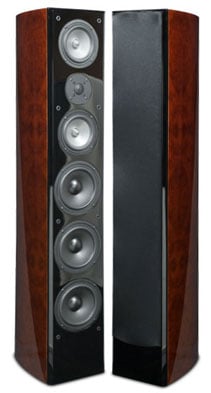

E55Ti TowerEMP E55Ti Floorstanding Speakers
When it comes to tower speakers that look great and actually sound good, EMPTek offers some of the best budget solutions from what we’ve tested. The E55Ti ($795/pr) is a significant upgrade over the older E5Ti ($500/pr) which we feel is worth the price difference. The E55Ti’s just have a much bigger and more effortless sound to them and their tall stature just makes for a great visual impression. It's a 6 driver tower boasting (3) 6 1/2" bass drivers, dual 5 1/4" phase plug mids arranged in an MTM configuration with a 1 " fabric dome tweeter sandwiched in the middle.

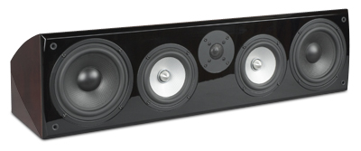

EMP’s original center channel E5Ci ($220) is a standard horizontally oriented MTM featuring dual 5 1/4” phase plug mid drivers and a 1” soft dome tweeter. It just doesn’t have the output capabilities to keep up with the E55Ti towers which is why they recently introduced the E56Ci ($450/ea) matching center channel. The E56Ci center channel is a 5 driver – 3-way rear ported speaker. It boasts dual 5-1/4” poly matrix midrange drivers nestled with their 1” silk dome tweeter. An additional 6-1/2” polypropylene woofer is located at each end of the cabinet to extend bass response which EMP rates at 50Hz (-3dB). This speaker has dual rear ports but doesn’t come with port plugs for those installing it into a cabinet. Hopefully after reading this mini-review, EMP will remedy that.
EMP E56Ci Hero

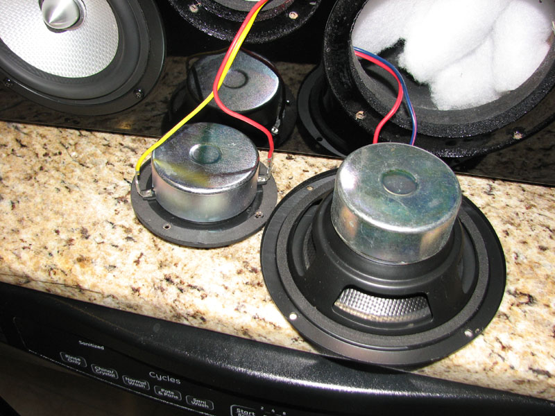

E56CI drivers   E56Ci Crossover
EMP E56Ci Center Channel Inside Look (drivers left pic; crossover right pic)

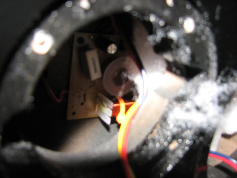

The E56Ci is quite a large center channel (31” wide) with an unobtrusive design. Its tapered cabinet and narrow height (8”) makes it fit in either above a display on a cabinet shelf or below it stand-mounted. I took apart the E56Ci to get a look at the internals. The E56Ci cabinet construction is very similar to the rest of their speakers (0.6” side walls and 1.2” thick front baffles). Thickening up the front baffle really adds a lot of rigidity to the speaker where it’s needed most and allows EMP to get away with slightly thinner than normal sidewall cabinets which also ultimately saves on shipping weight. While these speakers aren’t built to the standard of a multi thousand dollar speaker system from the likes of Revel, Usher Audio or RBH Sound Signature Series products, their construction and the materials used are on par with products in this price range and even slightly higher in some aspects. The drivers feature stamped baskets, which again is pretty standard for this price class of speaker. The crossover has a mix of air-core inductors and poly caps for critical circuit components and iron chokes for areas that aren’t as critical and also cost prohibitive than better performing and larger air-cores. The E56Ci is rated at 6-ohms with a sensitivity of 87dB / 1 watt and recommended for usage with 50-175 watts though we’d always recommend choosing more not less power amps when selecting your power source.

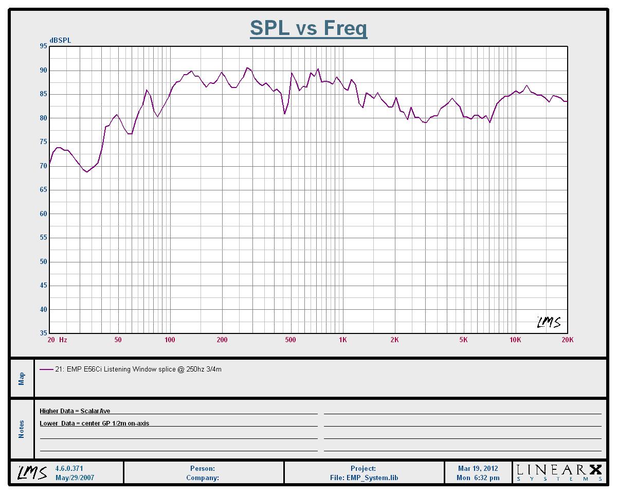

EMP E56Ci Measurement
EMP E56Ci Center Channel ¾ Meter In-Room Frequency Response without Port contribution
After installing the EMP E56CI center channel speaker into the entertainment center, I took five in-room measurements at 3/4 meters (+- 15 deg horizontal, +-15 deg vertical, and on-axis) averaged them and spliced them at 250Hz with an additional 3/4 meter groundplane measurement I made to derive a “listening room” response curve. The -5dB dip in the 2-5kHz range is exaggerated because the mic was a bit too close to the speaker to produce a fully converged farfield response.  I purposely did this to remove as much of the room influence from the measurement as possible without having to apply gating or smoothing to the measurement.  This also means the port contribution wasn’t factored in so you can expect more bass extension than what is shown in this measurement. Regardless, the response of this speaker is very linear both on and off-axis and the speaker produces good usable bass extension down to the 60Hz range.
E56CI w MoPads
EMP E56Ci Center channel with Auralex Mo-Pads

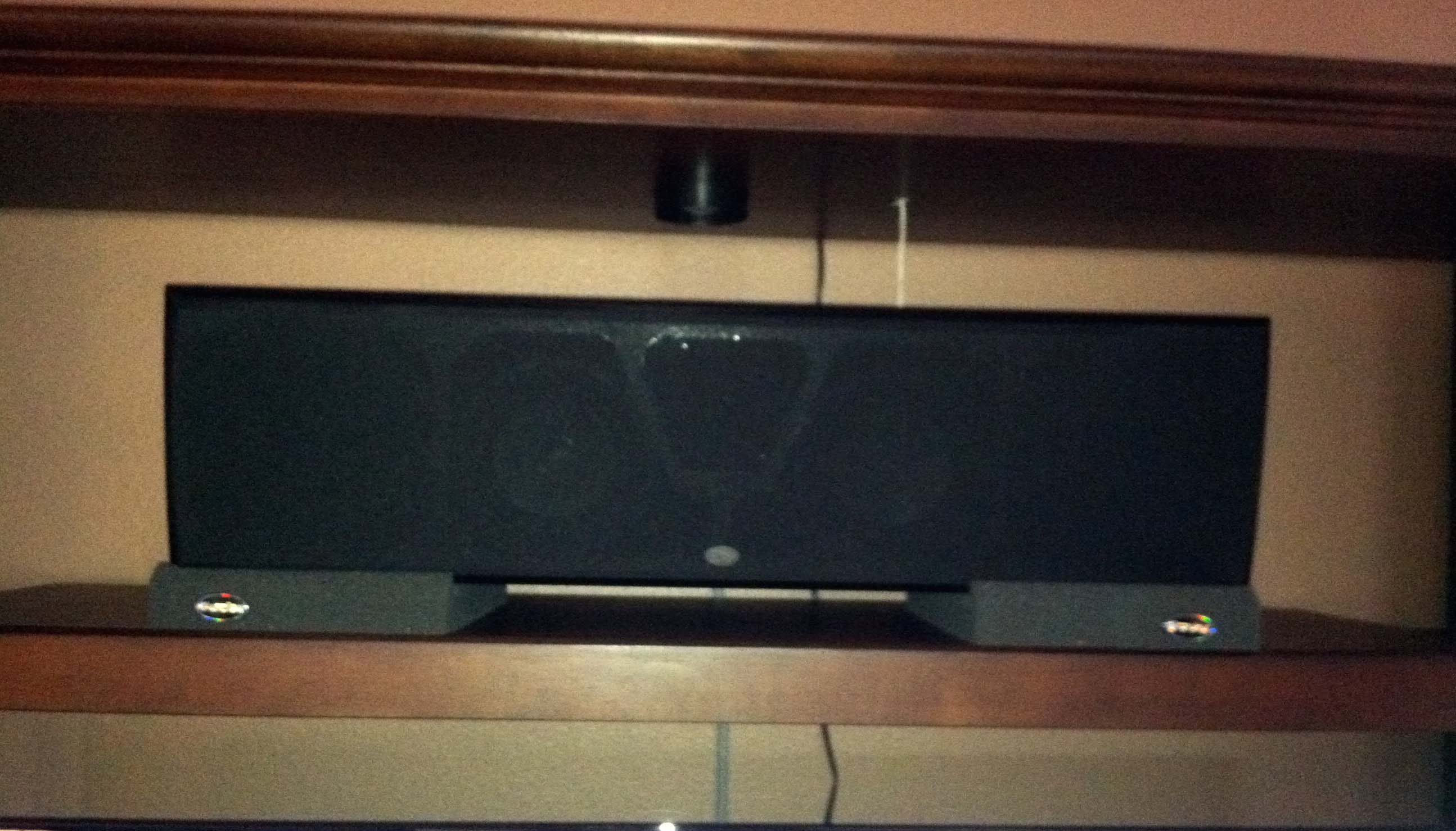

When installed in the wall unit, I initially measured a nasty peak at 250Hz which I determined was caused by resonance between the speaker and surface of the furniture it was installed in. To resolve this, I installed a pair of Auralex Mo-Pads which decoupled the speaker from the cabinet and also slightly tilted it down towards the listening area. I also crossed the speaker over at 80Hz to reduce the bass output which was necessary from the excessive boundary gain caused by it being placed into an enclosed area. This was a great tweak that ultimately made a significant impact on performance, most notably in vocal intelligibility which I will discuss in the listening portion of this article.

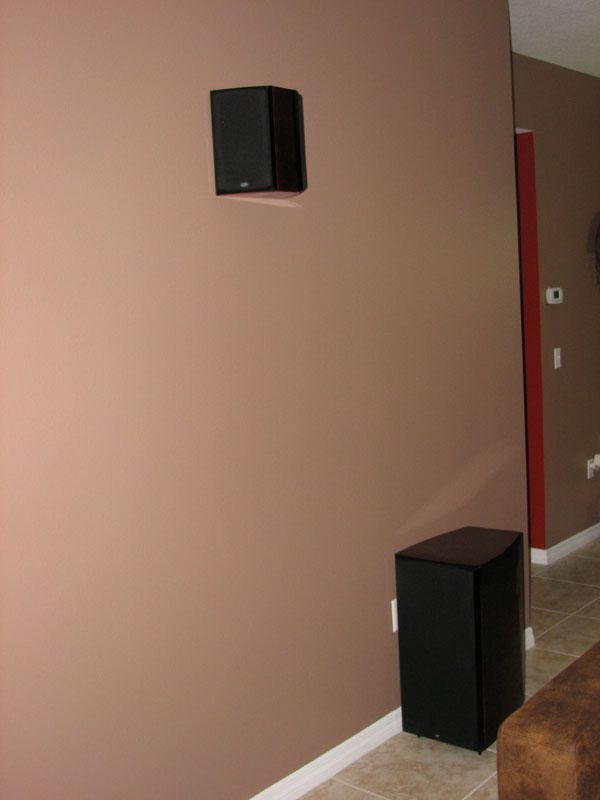

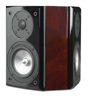

E55Wi HeroI’ve been waiting for EMP to release an on-wall surround speaker since they launched the brand a number of years ago.  The E55Wi ($499/pr) has two sets of 5 ¼” mid drivers with phase plugs and 1” silk dome tweeters located on two baffles 90 degrees apart.  The drivers are all in-phase meaning it’s a bi-pole type surround speaker.  The goal is to provide a wide surround field .  EMP chose to make all the drivers in phase because most people installing their speakers are only doing 5.1 systems.   Personally I like a hybrid variant where the forward firing tweeters are out of phase (dipole) to help better diffuse the surround soundfield at the listening position.  If you are running back channels, you may prefer this as well.  To accomplish this, simply remove the forward firing tweeter, reverse the phase and reinstall it for both speakers.  I recommend trying both ways to see what you prefer in your situation.  If you’re listening habits favor movies over music, you most likely will want the forward tweeter out of phase.
Hanging the E55Wi’s was a breeze.  I simply got me some concrete anchors, drilled them into the desired location on each wall separated by the same distance as the holes on the back of the speaker, inserted the screws leaving about ½” protrusion, and hung them like a picture frame. I was a bit disappointed EMP didn’t include the hardware to do this but I keep a large stock of concrete anchors in my tool box since my wife is always having me hang things around the house.

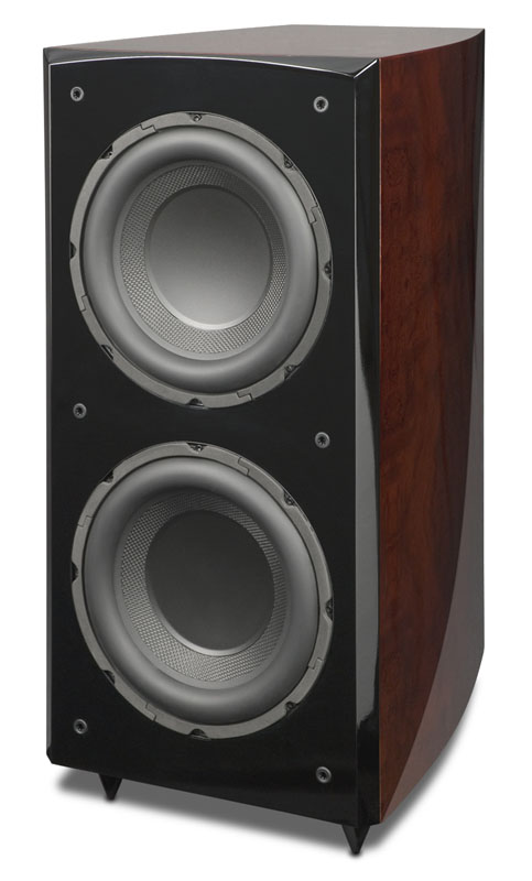

I just completed a fairly comprehensive review of the new EMP ES1010i subwoofer.  It’s basically a 250 watt powered dual 10” bottom ported sub with similar construction and aesthetics as the other EMP Impression series products.

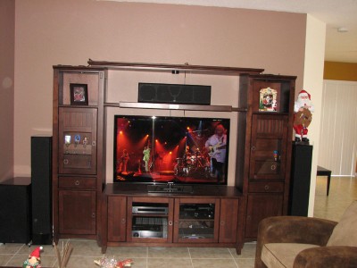

Prior to taking delivery of these subs, I was a bit reserved in recommending them knowing their low end output was a bit limited.  But, my sister-in-law wanted the subs to match the rest of the system and also not occupy too much floor space.  Surprisingly the ES1010i’s provided ample slam when run in pairs and with the E55Ti towers operating full-range.  Having four 10” drivers and six 6 ½” drivers playing bass into the room was truly an energizing experience.  At $499/ea these subs represent a good value and produce good bass in a very attractive and relatively compact form factor.

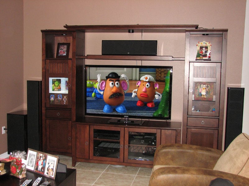

In order to maximize performance of this system while also preserving the aesthetics of the listening space which also functions as a family room open to a formal dining room, dual subs was a must but placement was challenging.

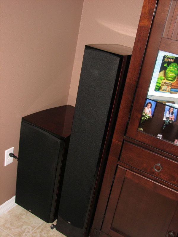

My sister-in-law under estimated the size of her wall unit and I was biting my nails when I initially saw it placed against the front wall of her room thinking I wouldn’t have enough space for the E55Ti’s and the ES1010i subwoofers.  I’ve always been pretty good at the game Tetris so I took my chances and moved stuff around till I got one of the subs to fit.
Sub 1    Sub 2
EMP ES1010i with E55ti tower (left pic); ES1010i & E55Wi Surround (right pic)

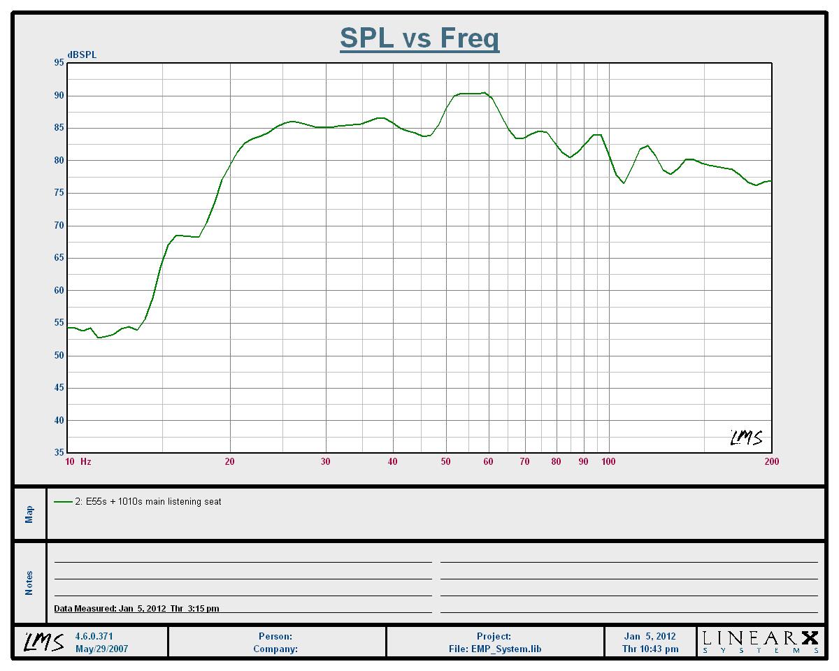

I diagonally located the other sub on the opposing wall.  This produced a pretty darn near ideal response across the entire couch facing the TV which is where they’d spend most of the time sitting and listening.  The response on the far left couch wasn’t as good but it was also pretty far off axis from the display too.  I always reserve such a less than desirable location as the “mother-in-law seat” and in this case mine was quite content sitting there.
EMP System In-Room

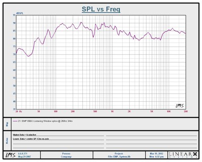

EMP E55Ti towers + Dual ES1010i Subwoofers In-Room Frequency Response @ Listening Area
As you can see, the response is very even from 200Hz down to about 25Hz with a gradual roll off (-5dB) at 20Hz. This measurement is NOT smoothed and was taken at 12ft where the primary couch is located.
