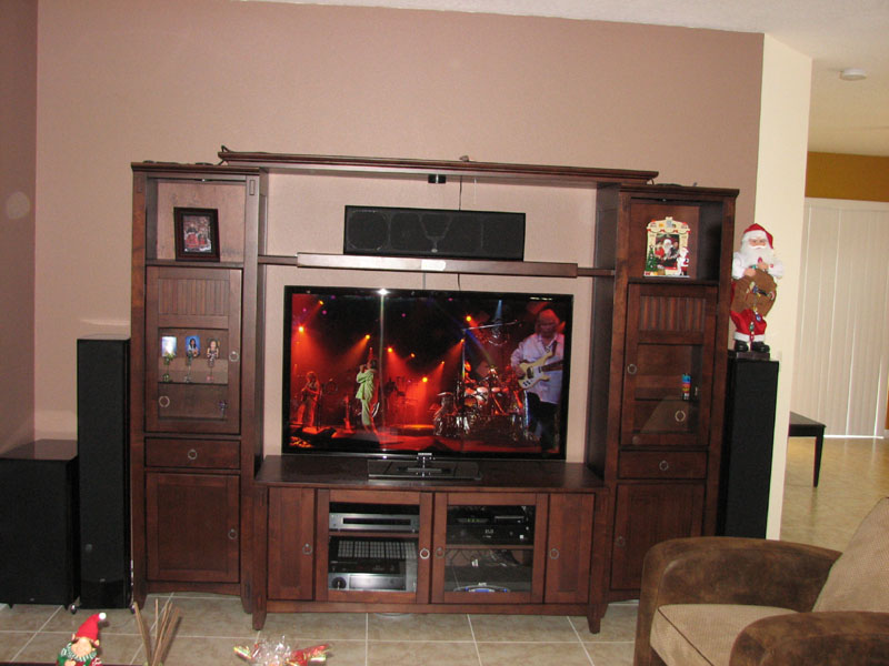

With the furniture secured, I drilled out bigger cutouts in the back to route the cabling (all furnished by Blue Jeans Cable) and power cords. I installed all of the components including an Ethernet hub to provide a wired Internet connection to the Samsung Display, Oppo BDP-93 Blu-ray player, Yamaha RX-A1010 A/V receiver and Nintendo Wii. This was necessary to tap into all of the networking features this system offers such as: Internet Radio, Pandora, Netflix and the iPhone App to control the receiver via your iPhone or iPad device.

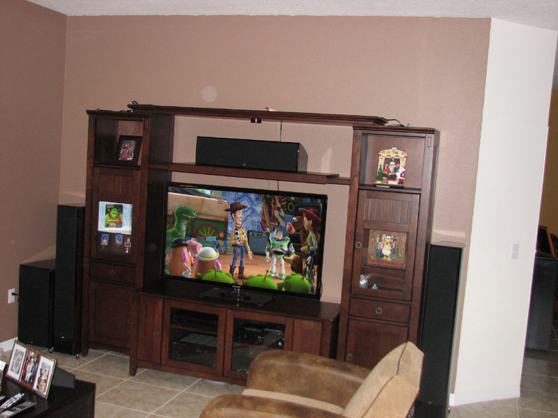

I managed to fit one ES1010i sub in the left front corner while positioning the E55ti towers adjacent to each side of the entertainment center and applied slight toe-in directed towards the center “money seat”. The outriggers were installed on the E55Ti’s to provide stability which is essential since my sister-in-law has a rather active 9 year old boy and a lot of visitors. Nothing is worse than watching one of your tower speakers from across the room take a dive from an accidental bump as you run in slow motion yelling “NO!” powerless to stop it. For the second ES1010i subwoofer, which was located on the right rear wall diagonal to the front left sub as previously mentioned, I placed electrical tape on the back panel controls to prevent people from tampering with its settings. This was important since the plate amp was facing the dining room, well within the line of site of curious visitors entering the room. The E55Wi on-wall surround speakers were mounted about 3 feet above ear height (seated position) on the side walls slightly behind the listening area. The TX-615 in-ceiling speakers were positioned about 8 feet apart. I left all tone controls to flat and did NOT pivot the tweeter since the speakers were firing directly down to the listening area (though a few feet back from the couch) from the ceiling and thought it was a better option to have the drivers firing slightly off-axis to provide a more diffuse soundfield.

I level matched all of the speakers to 75dB using my OmniMic calibrator kit SPL meter set to slow response, C-wt). The sub channel was deliberately set 3dB hot for added impact. I set speaker distance based on physically measured distances, while I manually adjusted subwoofer distance until I got the best blend between the main speakers and subs for the two primary seats, again using the OmniMic sweeping between 20Hz to 200Hz.
