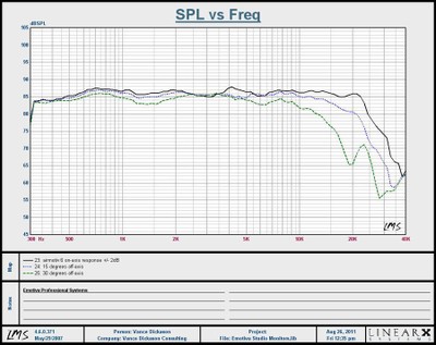

Not only are all the detailed specs of these new speakers clearly specified on the Emotiva Pro website, but a full battery of measurements are also included.
Emotiva Pro Airmotiv5 Frequency Response
Black trace - on axis; blue trace - 15 deg off axis; Green trace - 30 deg off axis
The frequency response graph is limited from 300Hz to 40kHz which was likely done as a gated measurement lacking resolution for lower frequencies. We look forward to doing a full comprehensive review of these products with measurements to follow.
