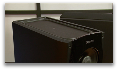

If you look at the speakers, you'll note they're really deep. A little over 15", making them nearly as deep as they are tall. There's a reason they're that big, too. The whole top of the speaker is a passive bass radiator, measuring 6x12. I think this design is partially to credit for the clarity of the speaker, even when the content gets thicker and you have tracks with more instrumentation that would normally just come out sounding muddled. The tweeter is a second-generation aluminum dome model with two 5-1/4" drivers that use aluminum cast baskets and a uniquely styled phase plug. The front drivers and tweeter are arranged in a true D'Appolito array and flush-mounted to the cabinet, but Definitive then placed a curved plastic cover overtop to reduce diffraction. And all of this is housed in an enclosure that, when you knock on it, sounds pretty solid.

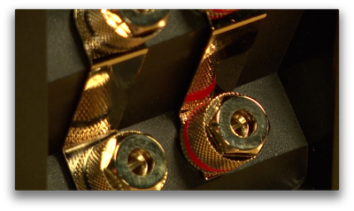

We opened up the Def Tech StudioMonitor 65's, 'cause that's what we do, and we're impressed by the amount of cross and corner bracing. It's no wonder the cabinet sounds so inert. There's also a minimal amount of batting and the 2nd order crossover looked to be made from quality components, including metal film caps and oversized inductors. When we were checking out the woofers we noticed they used a bucking magnet for focusing magnetic energy into the pole piece. The rear of the speakers feature a pair of high quality biampable and 5-way binding posts.
