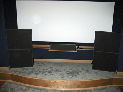

The environment was my 16' x 22' theater room - approximately 3000 cu.ft. – Perhaps just a bit large for these economical speakers, but fairly comfortable for the reviewers if I do say so myself. The front wall and 1st reflection points are treated with absorption. Speakers were placed on stands on the stage which put most of them a few inches above ear-level for front row listeners, and a couple inches below for the back row.

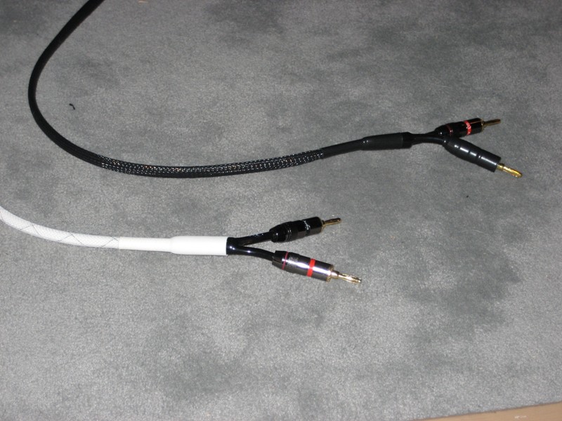

WhBkCablesThere were nine pairs of entry level bookshelf speakers in the face-off (originally 10, but a kit-built pair was eliminated very early due to a flaw in construction by yours truly). All comparisons were made two sets at a time, A vs. B, selected at random from the group. The speakers were set up as A B on the left side and A B on the right side so that the spacing between the pairs was about equal. Each pair was numbered on the back, and my son chose which pair competed with which, and recorded the numbers and cable attachments for each session. The speaker cables were only identified as “White” and “Black”, with corresponding tech-flex coverings to make it easy for him. An accomplished software engineer, but a total novice in audio (where did I go wrong?), he made no attempt to match up similarly sized, performing, or designed speakers. He would try to vary the cable connections when a particular speaker came around again, but didn't make that a big priority. All of this was done behind a speaker-cloth screen wall, so we never know which pairs were playing at any particular time (there were usually a few speakers outside the screened portion, so we could probably narrow the field a bit, but nobody really cared enough to try). When he completed his speaker swap, we level-matched the two pairs with an analog SPL meter and pink noise off a calibration DVD. The source was a Panasonic Blu-ray player with L/R analog connections to a Yamaha RX-V3900. Switching was done between two Zones in "Straight" stereo mode without a subwoofer (I like using the "Pure Direct" mode when trying out speakers, but apparently that won't work when using multiple zones). The participants had control over when the speakers were switched, and always knew which zone was playing, since we used the Yammy remotes to mute one or the other. There was no time limit imposed - a session ended when everyone was through with their evaluation.
