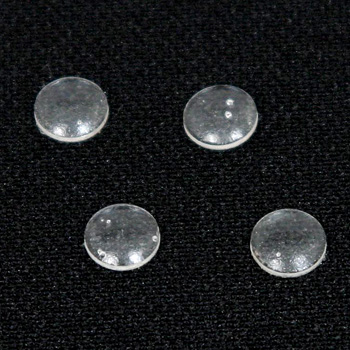

Axiom feetAxiom employs the same magnetic grilles and silver color dust cap aluminum cone drivers found on all of their V3 products.  Designed to place dialogue right in the center of the action, the VP160v3 Center Channel features the identical 6.5-inch woofers, 5.25-inch mid-woofer, and 1-inch titanium tweeter as the M60v3 tower speaker. Axiom claims that using the same drivers gives the listener a seamless soundstage across the front array. In order to match the kind of serious output the M60v3 floor standing speaker can provide, Axiom had to build a "monster" center channel.  The VP160v3 weighs in at an impressive 43 pounds - not for the faint of heart!  Because of its significant weight, the company does not recommend wall-mounting the speaker.  Instead, they suggest putting it on a shelf or the dedicated stand available on their site, the FMS 160. Also included in the speaker are two signature vortex ports. These are corrugated ports exclusive to Axiom Audio and their unique shape is designed to eliminate port noise, allowing for even greater sound output from a smaller cabinet.  They even include some cool gel-like rounded transparent feet which are lower profile and more appropriate than using spikes or metal cones and which also provide isolation from panel resonances if placed inside of an entertainment center.
