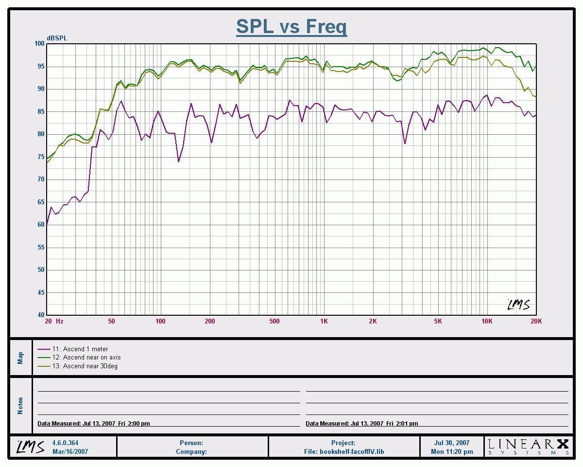

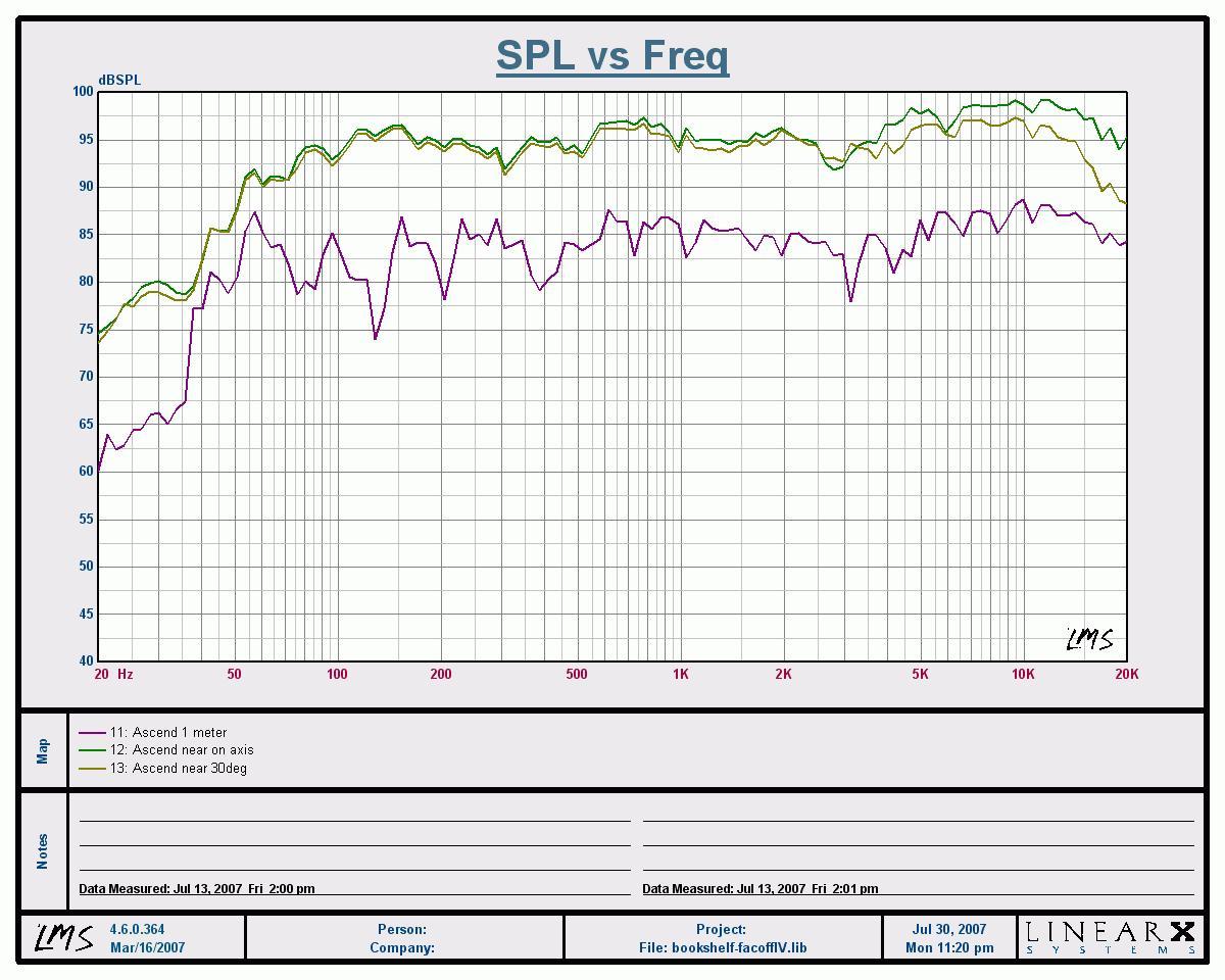

To get a better idea of what was going on, we pulled a few measurements of the Sierra 1’s. There is a slight dip in the 1kHz to 4kHz range both at 1 meter and via nearfield measurements on/off axis.  Or, another way to look at it is there is a slight elevated response in the 5kHz to 10kHz region.  This may explain why Tom felt the midrange was a bit recessed in his listening sessions.  Bass is definitely a strong point for these speakers with a 3dB point in the upper 40Hz region.  Though don’t expect to get high SPL’s at these frequencies as you are limited by the cone excursion of such a small woofer.  We still recommend crossing these speakers over at 80Hz and letting a good sub or two handle the bass duties below that region.

Though we didn’t measure impedance/ phase, judging by the manufacturers measurements the +-45deg phase shift and relatively moderate sensitivity and 5 ohm impedance magnitude in the lower frequency band suggests usage of quality amplification from the likes of Emotiva, B&K, etc is advised.  We measured an average sensitivity of 86dB at 1 watt so don’t be alarmed that these speakers will need quite a powerful amplifier (recommended 100+ watts) to play loudly in large rooms.
