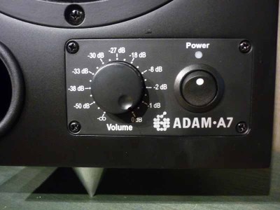

  • Sparkling treble
  • Focused bass response
  • Power switch and volume on front
  • Small footprint/ big sound
  • Great price for quality
  • None worth mentioning
Introduction
The ADAM A7 ($1149/pr) is a two way near-field studio monitor with the aforementioned tweeter and a 6.5 in. carbon mid/bass driver. This is all powered by two 50-watt amplifiers (one per driver.) Housed in an attractive black cabinet that weighs 18 lbs and measures 13in. high x 7.5in wide x 11in deep, the top front edges are beveled to reduce surface reflections from the tweeter.
