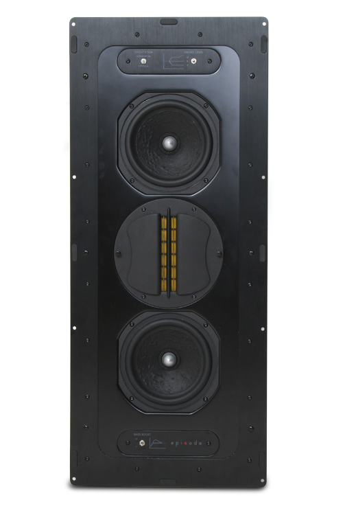

The ES-HT950-IW-7 (pictured above) is a more traditional in-wall speaker in that it has a single orientation - vertical. There is a 5.25" tri-layer honey cob cone midrange with an aluminum phase plug and a high temp voice coil at the top. At the bottom you'll notice dual 7" Natural Cell Structure woofers, again with aluminum phase plugs and high temperature voice coils. In between is the main feature of the new Episode 900 series speakers - the 4.65" Kapton film ribbon tweeter with aluminum conductor traces and neodynium magnet structure. The 950 is rated down to 48 Hz  and up to 40 kHz at -6dB (that -6 is most important on the low end since you stopped hearing it somewhere around 20kHz). This means you'll have little problem crossing it over with a subwoofer which you'll definitely need with that frequency response. The 87dB sensitivity and 4 ohm nominal impedance means you won't definitely need an amp if you spent a lot on your receiver, but you probably will get one anyhow.
ES-HT900-IWLCR-6-frontES-HT900-IWLCR-6 is a little different in design. It is a more traditional D'Appolito MTM design with the 4.65" Kapton film ribbon tweeter flanked on either side by a 6.5" NCS cone woofer with an aluminum phase plug and a high temp voice coil. The 900 (as the LCR in the name suggests) can be used either vertically or horizontally (you can rotate the tweeter for horizontal placement) so that it can be used either flanking a display or under/over it. This speaker has a rated frequency response (again at -6dB) from 65 Hz to 40 kHz. The 8 ohm impedance and 89 dB sensitivity means that you'll be able to pair this with a midline receiver in a smaller room if you have to.
What is interesting with this new SnapAV 900 series speakers is all they to to make sure they will sound good in your room. First, they include a backbox. This eliminates any problems you may have from an open-back solution. But it isn't just any back box, it is constructed out of 3/4" MDF making it extremely sturdy and inert. This makes for a fairly heavy speaker (the 950 is 41 lbs and the 900 is 26 lbs). Integrated in the boxes are screw operated tabs for grabbing on to drywall or studs. The 950 stands an impressive 41" while the LCR 900 is only 30" making it less than stud friendly (since they are typically 16 to 24 inches apart on center). But, honestly, you're probably not going to be installing these speakers yourself.
At $1999 each for the ES-HT950-IW-7 and $1199 each for the ES-HT900-IWLCR-6, these are definitely designed for the custom install market. And they've got the technology to back them up. Aside from the ribbon tweeters and overbuilt back boxes, the speakers have integrated cable management to their dual pairs of gold-plated binding posts, magnetic grills (which we are sure can be painted, and a number of EQ adjustments. You can adjust the bass (0/+3dB), the midrange (+2dB/0/-2dB) and the tweeter (+2dB/0/-2dB). On top of that they have a screen EQ if you plan on using them behind a perforated drop screen. This boosts the tweeter response 3dB over 8 kHz to compensate for the screen.
Are the new SnapAV Episode 900 speakers designed for the custom installation market? You bet. But we love seeing features such as overbuilt back boxes, separate EQ adjustments for bass, mids, and the tweeter with a compensation for perforated drop screens, and ribbon tweeters. The ES-HT900-IWLCR-6 is a little too wide for horizontal placement without cutting into a couple of studs but other than that, we love how both this and the ES-HT950-IW-7 look on paper. But, as is often the case with in-wall speakers, only you'll know how cool they are. Everyone else will wonder where that sound is coming from.
