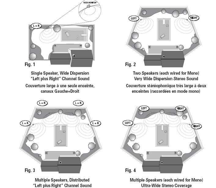

configurations.JPGThere are basically four ways to setup these speakers:
  • Single Speaker (L+R) Stereo Wired; Fig 1
  • Stereo pair (Left / Right) Mono Wire; Fig 2
  • Multiple Speakers (L+R) Stereo Wired; Distributed (4 or more); Fig 3
  • Multiple Speakers (Left/Right) Mono Wired; Distributed (4 or more); Fig 4
Unless otherwise noted, most of my testing was done as stereo pair mono wired (see Figure 2). I tried wiring them as a stereo pair dual wired to each channel like I did with the Boston Acoustics Voyager RK62T rock speakers, but I didn’t feel there were audible benefits other than a slight increase in output volume and all it did was add further demand on the amplifiers by halving the load impedance. In addition, Paradigm doesn’t even mention this option in their user manual so I stuck to their four recommendations depicted in this illustration only.
Figure 1 is optimal for small listening areas where only a single speaker can be utilized but still provide stereo imaging. Figure 2 is preferred if the installation can accommodate two speakers as it provides broader coverage and better stereo separation. Figures 3 and 4 depict installations of 4 or more speakers are distributed in a large listening area while the latter configuration is the ultimate solution for wide stereo imaging and if the installer wants to get fancy, they can even configure for surround sound. Imagine getting 5 of these rock speakers, a few subs, a projector screen and display and some lawn chairs for some outdoor viewing that all of your neighbors could enjoy too. Hmm, perhaps I need to start building a collection of rock speakers!

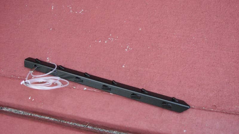

stakes.jpgBecause of their smallish size and very natural looking design, the 60-SMs truly blended seamlessly into my landscaping. I found that once I fired them up most people walking buy couldn’t locate where the sound was coming from. One of my neighbors commented that he wished he had that quality of sound in his own home, let alone his front yard. I was a bit concerned about all of the attention they were getting once I unveiled their location that I opted to install the supplied security stake and cables. Using a rubber mallet and an old piece of concrete I had laying in the garage, I pounded down the stake all the way into the ground once the wire was looped through the loophole in the speaker cabinet. I rested well that night knowing that the rocks were anchored down. It isn’t everyday that I leave a pair of $500 speakers outdoors, at least the Paradigms were somewhat secure do to their incognito design and stake grounding scheme.

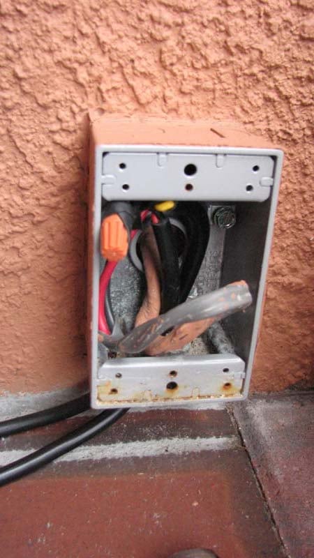

Editorial Note on Wiring:juncbox.jpg
I unfortunately took my prewiring of my home to the extreme by running all 10AWG speaker wires to every location. This made it quite a challenge to connect in wall volume controls as well as self containing the wires in junction boxes. A note to installers and audiophiles alike, you’re better off running 14/4 for redundancy and better flexibility. You can parallel them to yield an effective resistance of 11AWG. Paradigm provided standard wire nuts you get when buying ceiling fans or electronic fixtures. As an added precaution, I also used electrical tape in conjunction with the wire-ties to ensure total isolation and reduce the chances of oxidation from being outdoors.
