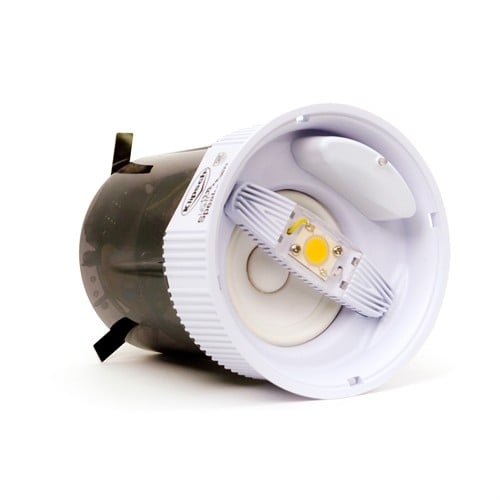

light-speakers-nakedKlipsch has introduced the LightSpeaker System Architectural Speakers at this year's CES. This speaker system consists of two LightSpeakers, a transmitter, and a remote. The installation is as brainless as it is brilliant - just screw the speakers in to existing 5- and 6-inch recessed light fixtures, plug in the transmitter, and enjoy the music! The speakers consist of a 2.5" Micro Cellulose Polymer cone with integrated high frequency disperser, a 20 watt amplifier, and a digital EQ. They are rated down to 90Hz and have 2 lenses and 4 trim rings (2 small / 2 large). The cool part though is that they also include a 2.4GHz wireless receiver and a 10 watt long life LED rated at 40,000 hours (replaces up to a 65 watt incandescent) which is fully dimmable and controlled from either the remote or the light buttons on the transmitter. This means that you can not only have your music but your light too!

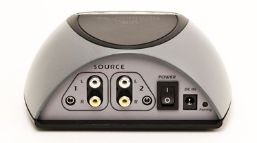

The transmitter will accept two inputs (either stereo RCA or 3.5mm) and can transmit up to two zones. According to Klipsch, the transmitter will work with up to 8 speakers at up to 50 feet. Each speaker has a left or right (mono would have been nice as well) and a Zone 1 or 2 selector switch. These are located at the bottom of the speaker where it connects to the Edison-type socket. You will have to uninstall the speaker to make changes. You can control what source goes to which Zone from the transmitter or the remote as well as lighting on and off plus dimming.
lightspeakers-trans_back
Here is where we run into the one criticism of the LightSpeaker System. Your existing dimmer wall switch is now unusable. Instead you'll need to use the remote or transmitter controls for just those lights that have been replaced with LightSpeakers. In the same vein, the trim rings may or may not match your existing lighting.
