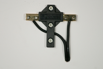

Axiom Power BracketThe M2, M3 and M22 on-walls are all ported. The VP100 and VP150 on-walls are not ported. The line-up comes with traditional grilles but we suspect that Axiom will make the move to magnetic across the board shortly. All the speakers are video shielded.   They are all listed on the Axiom Audio website with pictures and specs. Since the on-wall line-up was based on the hybrid in/on wall speaker counterparts the specs are similar (except for slightly less bass extension and efficiency for the on-wall versions).  All of the bookshelf speakers use the innovative Power Bracket combination wall bracket/binding post. We've had experience with this in our M0 review and overall like the way it works. Essentially, you wire to the bracket and slip the speakers on top. This holds the speaker flush to the wall (well, flush-ish) and makes the connection to the amplifier. Axiom has redesigned the bracket to address the few problems we noted in our M0 review to improve the security with locking mechanism, update the hardware and make it easier to align the speaker when attaching it to the bracket.
The center channels utilize the T-bracket long used by Axiom to wall mount their QS line of speakers. This makes sense as the Power Bracket is small and probably wouldn't hold the horizontally oriented speaker securely. With just one explosion played through one of their subs and the center would most likely come down. The T-bracket provides a very secure connection through it does mean that the VP100 and VP150 will need to be connected via traditional binding posts.
