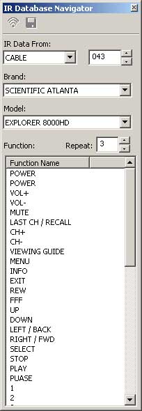

MX950_IRcodes_lg.jpgIR Database Navigator
The IR Database Navigator is a very direct way to call up discrete remote codes from any device in the Universal Remote Control library. Using the MX-950 Editor, simply select it from the Tools menu, choose the brand and model of the device control you wish to procure and then drag it to a button on the remote control. This is a very quick and easy way to utilize commands from devices other than the currently selected one without having to learn them (assuming the required codes are in the database).
