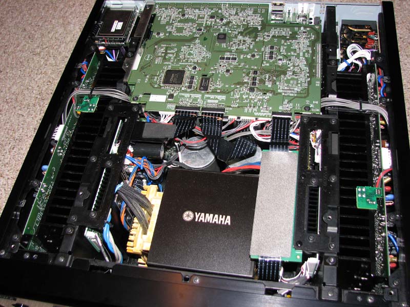

Z11inside.jpgJust as in the tradition of all past Yamaha flagship products, the RX-Z11 uses state of the art construction and parts. I was relieved to see the old modular design and horizontally mounted heat sinks of the RX-Z9 not find its way into this unit. The RX-Z11 utilizes about the largest E-core power transformer that I’ve seen, instead of the more space efficient toroidal found on its predecessor flagship receiver. The RX-Z11 screams flagship with its hefty and rigid chassis, huge power supply and ample heat sink area. E-core and Toroid transformer designs can be equally good provided they are used within their limits but an E-core typically takes up more real estate which Yamaha managed to cleverly tuck neatly into this hulking chassis. The heat sink is tapered to minimize resonance and also provide for optimal heat dissipation and the bottom of the chassis has two relatively large fans to keep the unit cool during high sustained output levels. The input fuse to the power transformer is rated at 15A / 250V and the power supply consists of two 27,000uF/75V capacitors for the seven main power amplifiers and two 8,200uF/50V caps for the presence channels. The audio pre-amp section, utilizes a bulk of capacitors that sum to about 30,000uF. The amplifier is a wide bandwidth design utilizing current mode feedback with virtually no phase shift to keep phase compensation to a minimum. This contributes to the RX-Z11's excellent transient response allowing frequency response to remain unchanged even when the gain changes (as you will see in my test data), to help create a warmer, texture-rich sound. With such a large power supply, plenty of heat sink area and ample cooling, and THX Ultra2 Plus certification, the amplifier section in this receiver is ready to pump out some serious wattage when called upon but also handle the most delicate musical passages with finesse to appease the heart of a true audiophile.
