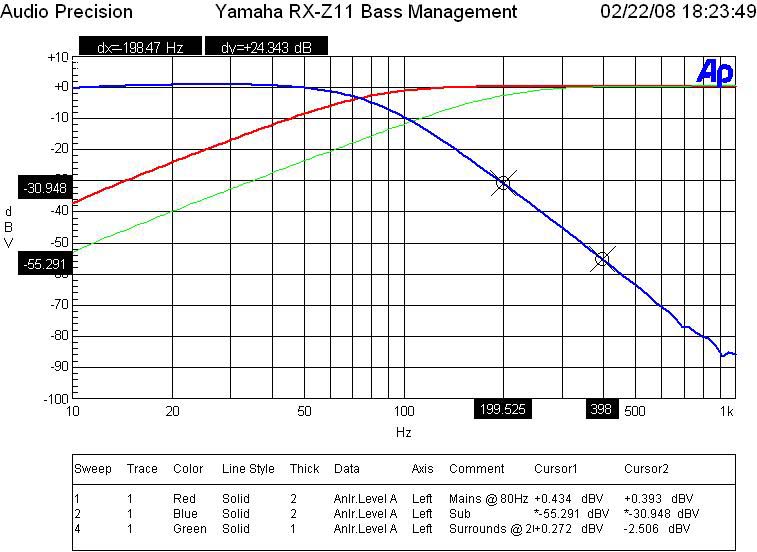

Yamaha took bass management up a notch by allowing variable crossover settings per speaker group (IE. Mains, Center, Surrounds but didn’t give you a choice for the subwoofer crossover which I found through my testing to be dependent on the main channel crossover setting. Thus I highly recommend you keep each speaker groups crossover setting within 20Hz else the bass in the channels crossed over higher than the mains will NOT be recombined into the subwoofer channel.

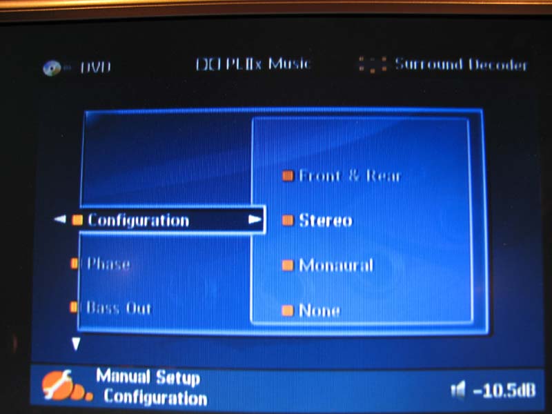

Yamaha offers dual subwoofer outputs on the RX-Z11 just like they did in previous flagships. This time however, they allow you to assign them as (stereo, mono, or front/back). Do NOT use the “front/back” setting as they made the classic mistake Denon did on the AVR-5805 where the back subwoofer gets LFE info and the front sub gets the bass from all the other channels set to “small”. Ideally in a multi subwoofer system, you want all subs playing identical signals or at least split between Left/Right with LFE going to all subwoofers so you can take full advantage of modal averaging to achieve the smoothest bass response across all of the theater seats.
Z11-bassmgmt.JPGIf you are connecting only one subwoofer, select “mono” and be sure to use the “left” sub output since that is the only one with level control in that particular configuration. Strangely the RX-Z11 still outputs signal via the “Right” subwoofer output but its referenced to a 0dB trim setting so you don’t have independent level control over it other than master volume. I also noted that if you set the main channels to “small”, the RX-Z11 still allows you to set the center and surround channels to “large”. I would have preferred Yamaha to automatically set all speakers to “small” if the mains were set “small”. But, since they didn’t, pay extra attention to this when configuring your bass management settings.
The crossovers worked as expected for a THX Ultra2 certified receiver as indicated by the 12dB/oct High Pass Filter (HPF) slopes on speakers set small and 24dB/oct Low Pass Filter (LPF) slopes on the subwoofer output which I measured with my Audio Precision SYS 2722 Audio Analyzer.

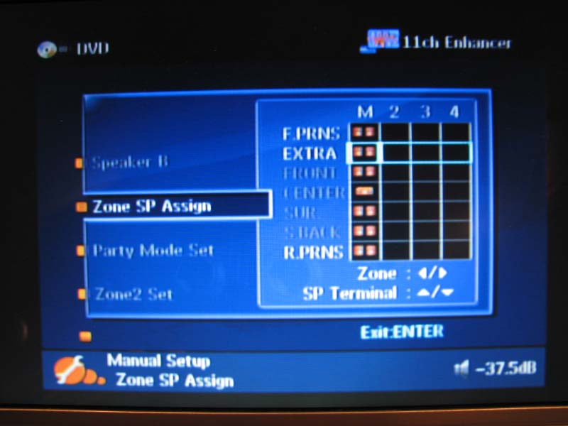

speakerassign.jpgYamaha has really outdone themselves with all of the power amplifier options on the RX-Z11. The RX-Z11 comes equipped with a “preamp mode” which essentially shuts down the amplifiers not being used and will allow you to reassign all 11 channels to zones 2, 3 and 4. So basically if you desire to add a high quality 7-channel amplifier for the main zone, this receiver can support simultaneous 4 zones, 4 source audio. Alternatively you can connect external power amplifiers to each of the additional zones to power them. This is an extremely thoughtful and useful feature for those integrating a multi zone distributed whole house audio solution with their primary home theater room. There is even a bi-amp mode which takes the surround back channels and duplicates the signal from the main channels for those wanting to biamp their main speakers. I don’t understand why Yamaha forces you to enter the advanced setup menu as opposed to provisioning that option on the main power amp assignability page. Keep in mind however if you bi-amp you sacrifice the back channels.
The RX-Z11 doesn’t just stop with all these cool amplifier assignability options for the additional zones. Zone 2 also features a coaxial digital output so you can play back any of your digital audio sources to remote zones. A prime example here would be someone connecting a YSP-4000 in another room wanting to pass through the audio from their main zone DVD player and Cable box. Please note however that when you connect the external amplifiers in Zone 2, Zone 3, and/or Zone 4 to the ZONE OUT jacks of this unit, the RX-Z11 can only transmit the analog audio signals. In this setting, this unit cannot play back the digital audio sources input at the Digital In jacks and HDMI In jacks in Zone 2, Zone 3, and/or Zone 4. When this unit is in the “Party mode”, it can output the audio signals input at the HDMI In jacks or Digital In jacks at the analog Zone Out jacks. When you connect an external amplifier in Zone 2 to the Zone Digital Out (Coaxial) jack, you can play back the digital and analog audio sources in Zone 2.
The RX-Z11 also comes fully armed with video support allowing component video upconversion in one of the zones and composite video for the additional two zones. So not only can you distribute audio all around the house, but you can do video as well. The DSP “Party” mode is a must have feature for those hosting social events. It allows you to play the same source through all of the speakers in the main zone and any or all of the other zones simultaneously. The RX-Z11 offers some of the most comprehensive multi zone / multi source options in a receiver that I haven’t seen the likes of since the Denon AVR-5805. It truly is a one box solution for distributed whole home audio and video especially when paired with a Yamaha MusicCAST MCX-2000 music server.
