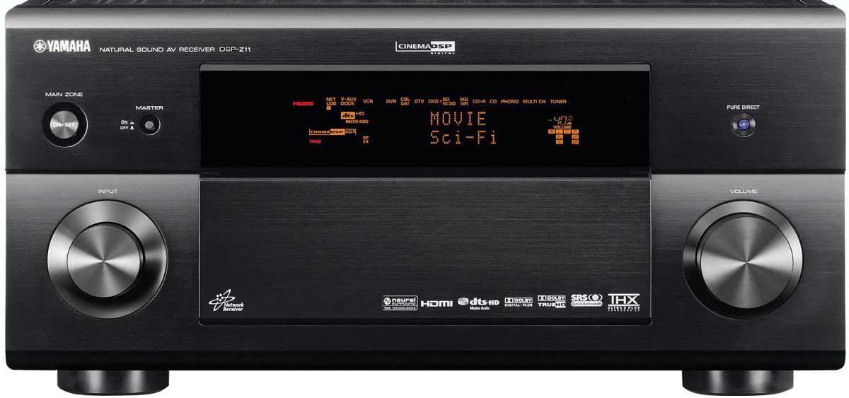

Yamaha RX-Z11 flagship receiver
> Read our Comprehensive Review of the Yamaha RX-Z11 <

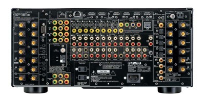

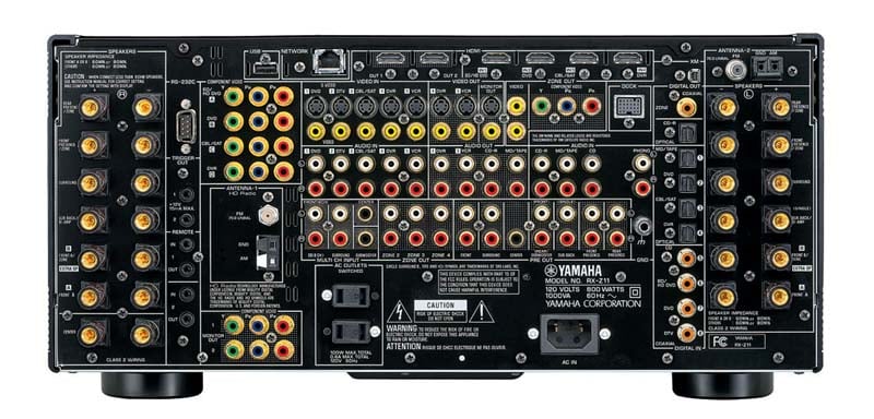

Yamaha has finally announced its new flagship receiver. The RX-Z11 is a 11.2 powerhouse that breaks all of boundaries of former Yamaha receivers and steps up to present more advanced features than anything else they have delivered to date. Combining amp assignability, raw power and networking features, the new flagship product aims to take on the role of central AV hub in the consumer home. From the look of the back panel this is one impressive beast of burden.
RX-Z11 Back

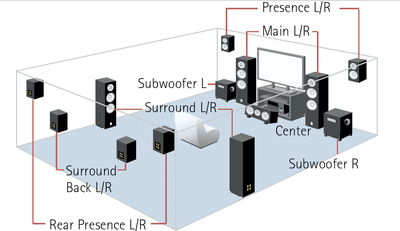

11.2 Surround - Are They Nutz?
First off is the new 11.2 moniker - how can you have 11.2 in a home theater system? With a lot of DSP... and speakers... and wall space... Taking a look at the picture below we see that Yamaha has added support for rear Presence speakers as well as Stereo Subwoofers. Yes, stereo, though we assume there is a way through bass management to allow for LFE and mono use as well. The end result is a (maximum) 11.2 audio system with the flexibility to scale back to 5.2 with up to 4 additional zones.
It's an interesting arrangement and we'll have to see how well it enhances the theatrical experience in real-world use. Not for the feint of heart, this new AV receiver has more channels (though very similar) than the new Audyssey 10.2 Surround format, and enough DSP to actually make use of them.

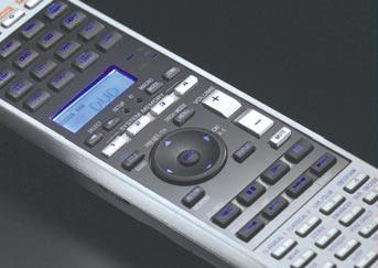

remote.jpgThe new Yamaha RX-Z11 sports a revised remote that is very similar in nature to the existing remote used by their receivers. The difference is a silver color and fully backlit keys that appear, on first glance, to actually be visible in the dark. Four system memory buttons are available on the front to store user configurations and settings and the remote is capable of being programmed to handle almost any component in the home theater.

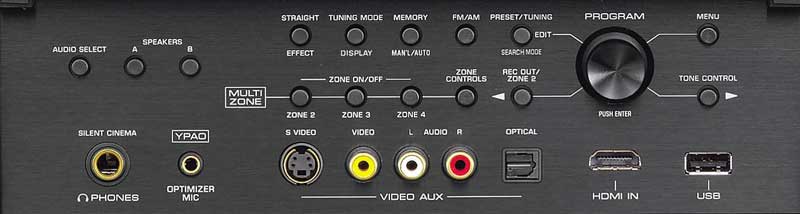

The hidden panel of the RX-Z11 features an additional HDMI input (bringing the total to 5) as well as the expected AV inputs with optical digital. Zones can be engaged and disengaged and the YPAO optimizer mic and headphone jacks are located here as well.

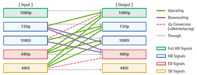

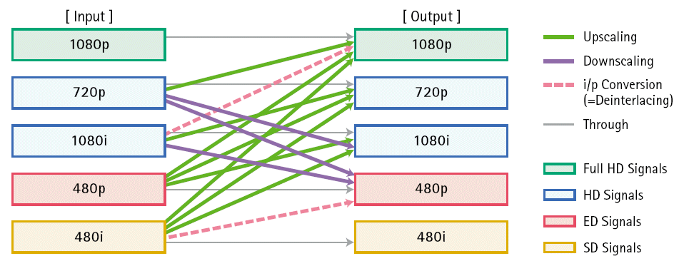

The Yamaha RX-Z11 can essentially scale up and down from any resolution to any other resolution. For the first time this includes HDMI and HD signals. For example, a 720p signal input over HDMI can now be scaled to 1080p. 1080i source signals via HDMI or component can also be deinterlaced to 1080p. This chart shows the basic metrics and possibilities:
