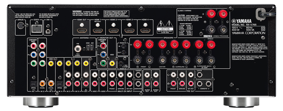

The RX-V765 has plenty of inputs and even iPod functionality - thanks to a multi-pin docking interface that works with the optional YDS-11 or YBA-10 iPod/iPhone docks. Four S/PDIF inputs (two coax and two optical) ensure ample connectivity for legacy DVD players, cable set top boxes and a gaming system, but you are really in for a treat should you make use of the 4 HDMI inputs. There is even a set of 7.1 analogue multi-channel inputs for those who are opposed to HDMI on principle (we know who you are!) A couple of parallel subwoofer preamp outputs means that you don't need a Y-cable in order to use two subs - which we recommend whenver possible for better and smoother bass response.
RX-V765 rear
Check out the larger chassis and 5-way binding posts for Zone2/Presence
