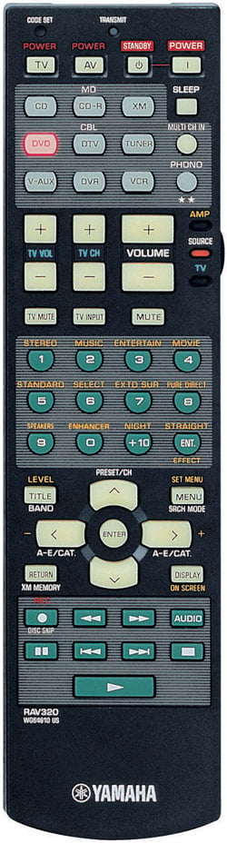

RemoteThe RAV remote controls are easy to operate, and have powerful feature sets though this model is somewhat limited in function compared to some of their higher end units. Now all we have to do is get Yamaha to fully backlight the RAV354 and we can retire the clapper.
  • Fits nicely in the hand, new thinner design
  • Dedicated receiver volume
  • Source switch for controlling inactive components
  • Seafoam button labels unreadable in dark, even with backlight
  • Backlight barely lights up keypad
  • Non learning remote - must rely on factory presets to control other products
The RAV320 is a basic functional remote one would come to expect in a product of this price class. It has no LCD display, no learning functions and very limited preprogrammed user codes for other manufacturers. Bottom line if you wish to operate your entire system off one remote, don't try to do it with this one. Very cost effective and excellent universal remotes can easily be had for $100 or less from brands like Harmony and Universal Remote. Leave this function to the companies that focus on nothing else but remote controls. The RAV320 did what it was supposed to do quite well - operate the RX-V659 receiver. Nothing more could really be stated here.
