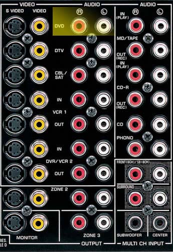

With all of the major I/O connectors on board, the RX-V4600 is as ready for the future as humanly possible at this price point. Two HDMI inputs, one output, dual active i.LINK, and EXT multi-channel analog inputs ensures all of the major formats are compatible with the RX-V4600. In the event of the emergence of newer surround formats such as DD+, the RX-V4600 sports an 8-channel external analog input. The receiver back panel was a bit crammed, but well arranged nonetheless with all of the digital audio and video connections on the far left, followed by analogue connections, then the speaker level connections, trigger connections and lastly the power cord and AC level connections.
extin.jpg Editorial Note About the External Analog Inputs on the RX-V4600
In order to utilize the 8CH inputs you must route the front outputs of your 8CH source into the DVD Inputs, and the Surround Back Outputs of your 8CH source into the Front/SB EXT Inputs. Then properly configure the Multi CH assignments in the GUI of the RX-V4600 for "8CH". Otherwise use the standard 6CH EXT analog inputs labeled on the back of the RX-V4600 for DVD-A/SACD, assuming your universal player doesn't have an active i.LINK / IEEE 1394 interface connection.

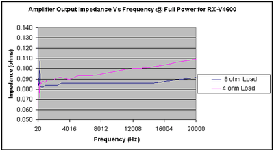

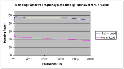

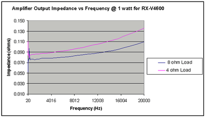

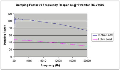

I recommend the "Minimum 8-ohms" setting even for 4-ohm speakers of moderate efficiency ( > 89dB SPL). Yamaha includes a" 6-ohm" setting to satisfy UL heat dissipation requirements when driving 4-ohm loads, as well as easing consumer concerns about driving low impedance loads. These switches step down voltage feed to the power sections which can limit dynamics and overall fidelity. My advice is to keep the switch set to "Minimum 8-ohms" regardless of the impedance of your speakers and ensure proper ventilation of the Receiver. To illustrate this point further, I have tabulated my measured differences between the 8-ohm and 6-ohm setting for driving 8-ohm and 4-ohm loads.
8-ohm setting: 134wpc into an 8-ohm load @ 0.1% THD; 210wpc into a 4-ohm load @ 0.1% THD
6-ohm setting: 95wpc into an 8-ohm load @ 0.1% THD; 180wpc into a 4-ohm load @ 0.1% THD

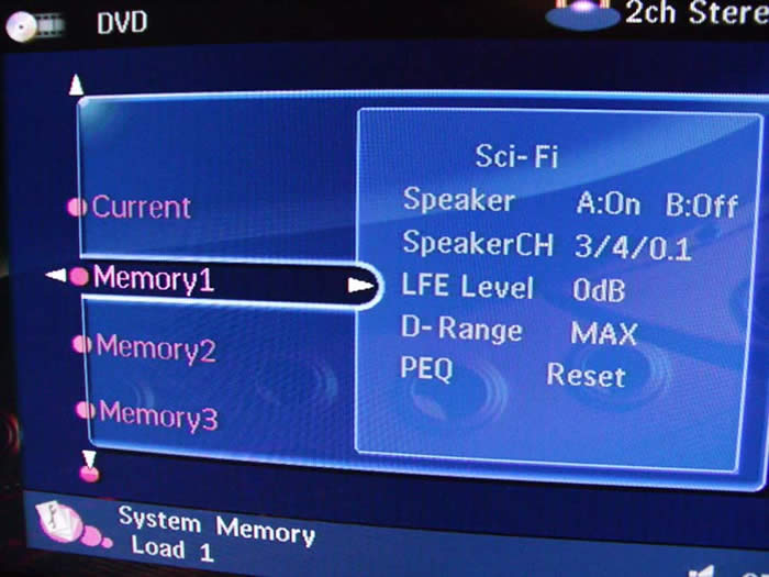

What really took me by surprise was the difficulty of defeating the PEQ. With prior YPAO Yamaha products it was a relatively easy matter of toggling between PEQ, GEQ or no EQ. In contrast with the RX-V4600 you had to enter each particular channel's audio setup and select "reset" to disengage the PEQ settings making it virtually impossible to do an A-B comparison and even more difficult for audiophytes to determine if it is even enabled or not. I even tried to engage the "Straight" mode to see if that would disable PEQ, but unfortunately t did not. In the end I did find a decent work around. By using the System Memory Settings feature (up to 6 storable allocations) of the RX-V4600, you can store independent Sound field program parameters, PEQ, Dynamic Range, LFE and speaker configuration settings. At this point it was a matter of toggling between Memory settings (#1 and #2 accessible on the remote) to do on-the-fly comparisons, though I would have preferred a single button toggle on the remote without the need to engage different memory banks.
RX-V4600 memoryComparing the auto level trim settings via the internal test tones, I found channel to channel balance to be matched within +-0.5dB, while speaker distances were pretty much dead on or closer than I could have gotten with a tape measure. But double check the subwoofer distance is accurate within a few feet as I have often found auto systems tend to incorrectly set the distance, especially if the sub is placed in close proximity to the listening position. YPAO was no exception and set my subwoofer distance to 22ft when it was actually only about 12ft away. Speaker sizes and crossover settings varied each time I ran the auto setup, thus I recommend taking your results with a grain of salt. Know your speakers and determine if the size and crossover settings are appropriate or not. If you aren't sure, consult your dealer and/ or loudspeaker manufacturer. At the very minimum, I would suggest using the auto setup feature for speaker level and distances since for the most part, they are at best relatively accurate and a good starting point for tweaking more accurate system performance. If you decide on using PEQ, Yamaha provides user flexibility to contour its response to your liking (a new feature not found on previous generation YPAO enabled receivers).
