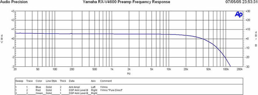

Frequency Response
The frequency response out of the preamp was ruler flat in the audio band (20Hz to 20kHz +-0.1dB) with a -3dB point around 120kHz. I also observed no measurable difference between "Straight" and "Pure Direct".

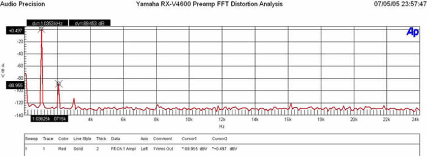

FFT Distortion Analysis
When the analog preamp was driven at 1Vrms (typically ½ signal strength to achieve ½ of max power of most power amps with voltage gain of 29dB) distortion levels were (+0.497 + 88.955 = 89.452dBv) or 100*alog(-89.452/20) = .00337% This is certainly a commendably low distortion figure.

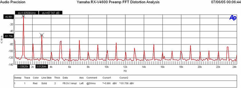

At 2Vrms, the preamp section of the RX-V4600 faltered. This is because Yamaha was likely using only a single rail 5V supply for the preamp section. I would prefer to see a preamp have the ability of driving 2Vrms undistorted to accommodate a wider assortment of power amplifiers. Though this didn't present any audible nasties when I used the RX-V4600 as a preamp to my Emotiva MPS-1 power amp, my advice here is to choose a power amp that can achieve maximum power output with about a 1.5Vrms input should you decide on buttressing your system with external amplification.

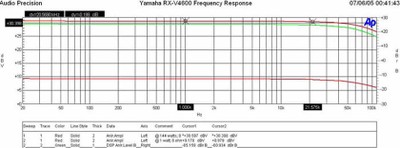

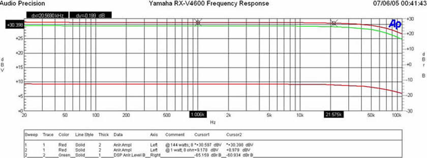

Frequency response uniformity over all power levels was excellent (within +-0.1dB from 20Hz to 20kHz).
