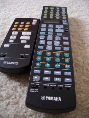

RXV4600Remotes
The main remote for the RX-V4600 is essentially the same as the one supplied for the RX-V2500.  However, the little companion remote (left) is an added goodie for controlling zones 2 & 3.
