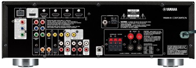

The back of the RX-V367 is fairly spartan, as you'd expect with an entry level receiver. The main channels get five-way binding posts while the rest of the channels are relegated to the spring-type. There are an impressive four HDMI inputs and one output, and two component and four composite inputs (there is a composite input on the front panel as well). There is a single subwoofer output (Yamaha includes two on higher priced models) and a dock input for adding either the YBA-10 Bluetooth or YDS-11/12 iPod dock (additional purchase required). For digital audio inputs you get two each coaxial and optical.
