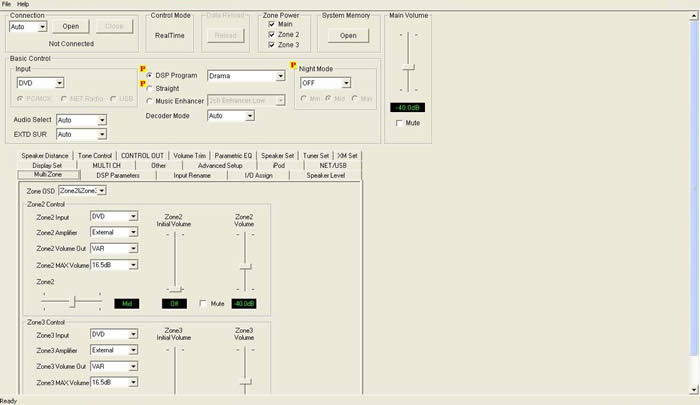

receiver-editorReceiver Editor
A custom installer’s delight, Yamaha has been offering this feature since the introduction of their flagship the RX-V2400 over four years ago. Using Yamaha’s proprietary software and an RS-232 connection between your computer and the interface on the back of the RX-V2700, you can plug away at configuring the entire receiver without having to use the GUI or your display. Best of all, if you or your customer happens to mess up some of the settings on the receiver after it’s calibrated; you can recall the settings in an instant and restore the receiver to its proper calibration. Of course, I highly recommend engaging the “Memory Guard” feature of this receiver after you complete the setup and calibration to avoid such an occurrence.

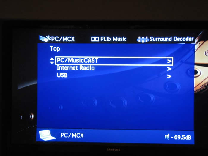

(Inter)Net Radio

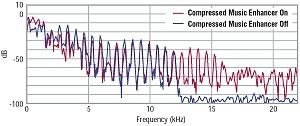

By selecting the input labeled Net/USB, setting the remote control to “Net” then sliding the side function mode selector switch to “source” you enter the Network world of the Yamaha RX-V2700. I found literally hundreds of Net radio stations categorized by Genre, Location, Popular Stations, and Podcasts. While this was a super cool feature, especially since it’s free and opens the doors to an almost limitless avenue of new music, the poor sound quality on most stations made this service unpalatable even when engaging Yamaha’s Music Enhancer feature. The Music Enhancer feature did manage to extend the high and low frequency response, but it was unable to combat the excessive amount of compression and phase issues that made most of the channels sound about as good as AM radio without the static. Am I being too picky? Perhaps, but I am not the type to fall for the Dumbing Down of Audio that seems to be the status quo in an era of streaming music and compressed portable audio services.
enhancer_000Oddly when I selected the “Holiday Music” genre, I got Nirvana and Stone Temple Pilots on the North Pole station. I guess Santa must be in a Rockin’ mood once the holiday season is over.
One saving grace to Net Radio is I did manage to find a selection of Jazz stations that didn’t sound half bad, especially when I engaged Yamaha’s Music Enhancer 2CH and 7CH modes. The bottom line is that when you find a higher quality station, make sure you program it in memory for future access.

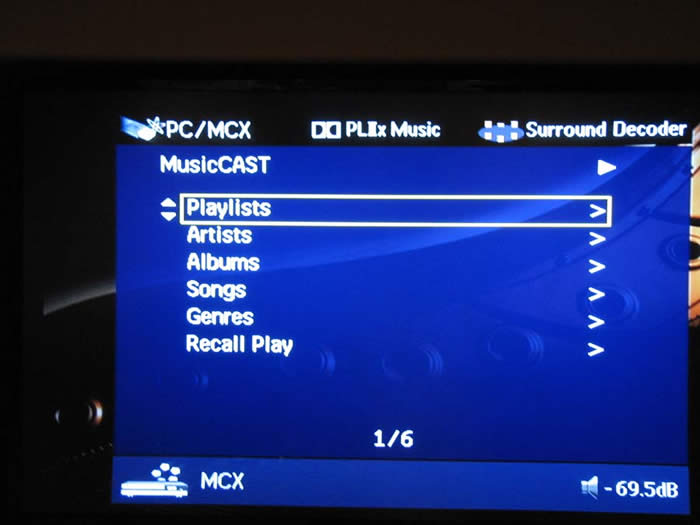

MusicCAST MCX-2000
Networking the RX-V2700 to my MusicCAST MCX-2000 was easy as pie. All I had to do was go into the setup of my MCX-2000 and hit Auto Configure. It found the RX-V2700 and treated it as a remote client. I then selected the PC/MusicCAST option on the OSD (use “display” button on the remote when engaged in Net mode).
Editorial Note on Streaming Music from MusicCAST
When streaming music from MusicCAST MCX-2000 to the RX-V2700, it’s important to note that MusicCAST defaults PCM to MP3 conversion of remote clients. MusicCAST does provision for sending one remote client PCM data. If you are already sending PCM data to another remote client,, I would suggest using this feature for zone2/3 audio and using the primary MusicCAST system for the main zone to allow true PCM data to be faithfully produced for the greatest fidelity.
Having the network feature for MusicCAST is very useful in this receiver. It provides the ability to stream independent musical sources for all 3 zones (Main, Zone 2, Zone 3) by just having only one additional remote client for the MusicCAST system. In my setup, I used the MCX-2000 base unit for the main zone and streamed different music to Zone 2 from RX-V2700 remote client while watching TV in Zone 3 all off one receiver!backXM

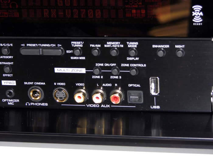

Once again, The RX-V2700 showed off its Network muscles by allowing users to stream music directly off a PC connected in the network. Files such as WAV (PCM format only), MP3 and WMA are supported. I was right at home with this feature as I have a ton of older progressive rock music on my PC hard drive that I’d love to hear on my stereo system. As an added bonus, you could even store some music files on a USB flash drive or portable hard drive and connect it right to the front panel USB connector for instant access to your music.
