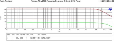

 Power Bandwidth
freq-full
Figure 4. Yamaha RX-V2700 Frequency Response at 1 watt & Full Power
The Yamaha RX-V2700 possesses a wide bandwidth amplifier topology with a -3dB point in excess of 100 kHz at 1 watt.  At full power, we start seeing some loss of bandwidth but the -3dB point is still above 70 kHz (well beyond the range of human hearing).
At full continuous unclipped power and bandwidth (> 0.1% THD + N) the RX-V2700 delivered the goods, 144wpc x 1 and 90wpc x 4 (bi-amp mode) into 8 ohm loads, while still maintained excellent bandwidth linearity with a -3dB point of 70kHz.
Into 4 ohms, the RX-V2700 was able to deliver continuous power levels at a whopping 272wpc x 1 and 230wpc x 2 with less than 0.1% THD + N.
Keep in mind most review publications don’t do continuous power measurements and they usually publish power measurements into clipping at 1% THD + N. Our measurements are very conservative and it is clear that this receiver is among the most powerful in its price class.

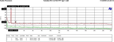

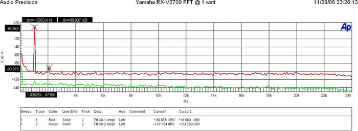

FFT Distortion Analysis
FFT-1watt
Figure 5. FFT Analysis @ 1 watt
At 1 watt into 8 ohms, the RX-V2700 displayed exemplary results (+8.963 + 90.975)dBv = 99.94dBv or 100*alog^-1(-99.94/20) = .001% THD + N.

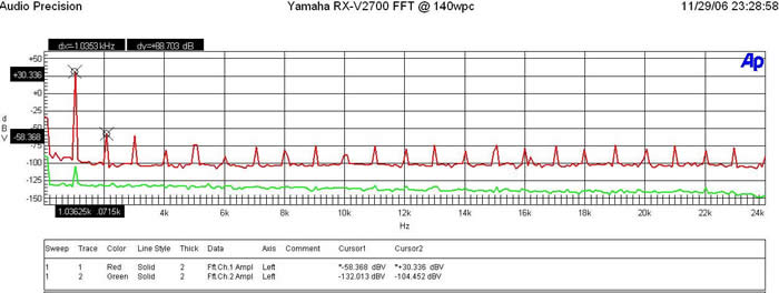

FFT-140watt
Figure 6.  FFT Analysis @ 140 watts
At full rated power (140wpc, 8 ohms) the RX-V2700 again exhibited excellent distortion measurements (30.336 + 58.368)dBv =88.7dBv or 100*alog^-1(-88.7/20) = .0037 THD + N

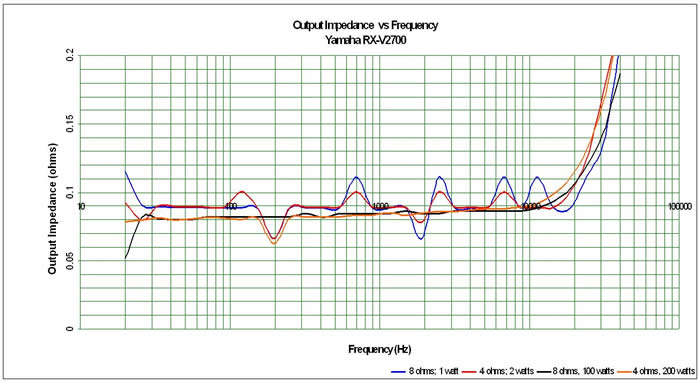

Zout
Figure 7. Amplifier Output Impedance under various loading conditions
The amplifier output impedance fell right within our desired 100 mohm or less mark for the entire audible bandwidth up to 20kHz.  It was nice to see that even when the RX-V2700 was pumping out 200wpc into a 4 ohm load, the amp maintained good linearity.  This is a marked improvement over Yamaha predecessor units in this price class and is among the best compared to its peers.

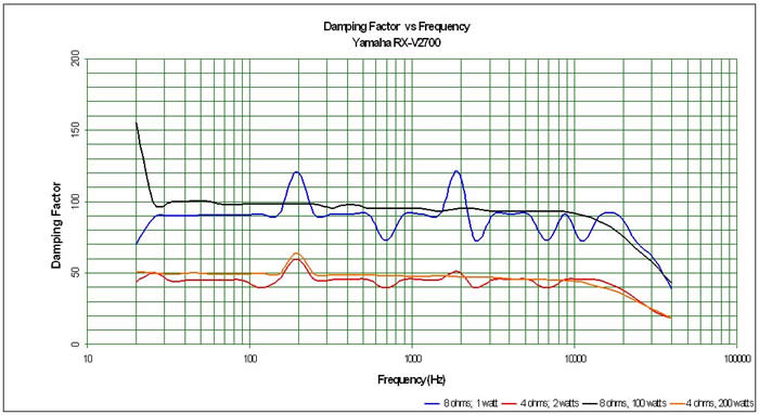

damping1
Figure 8. Amplifier Damping Factor under various loading conditions
The amplifier damping factor is about what I expected based on the measured output impedance.  It is uniformly good across the entire audio frequency range and falls slightly under the 100 mark (50 is a minimum we like to see in all amplifiers) when driving an 8 ohm load above 1kHz we like to see on uncompromising designs.  The amplifier doesn’t fall apart when driving 4 ohm loads like some of Yamaha’s earlier models.
